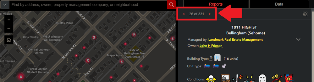

AlbrechtDylan
Feature selection for the feature info widget is no longer centered. I couldn't find any information about this change with the update notes and am looking for a way to revert it. Any suggestions or similar experiences?

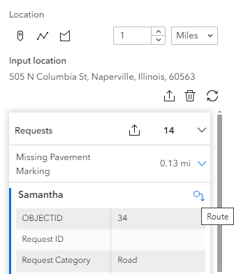

barryguidry1
Jianxia,
can you please view my video below, and let me know if the reason I am required to enter the address twice in the Get Directions option of the Near Me widget is a known issue? - Thank you.
https://youtu.be/eTeSsOXFGI8
Barry
AlbrechtDylan
@Jianxia
here’s a screenshot ($h*t Rental Radar) showing Feature Selection for the Feature Info widget now left-aligned, whereas it was previously centered. The Title element has also become left-aligned. I was able to center the title (address) by moving it into Content, but there are no options available to adjust the position of Feature Selection.
Any ideas or is this something I could bring up with customer support?

AzizaParveen1
Hi @barryguidry1,
You are using query widget in your app. Near Me supports direction when direction widget is configured in the app and you have point  data.  The action is called Route, you don't need to enter your address twice if you get direction from Near Me.
Jianxia
@AlbrechtDylan, thanks for sharing. The left-aligned feature navigation is by design. In this release, Feature Info widget is refactored to display features from multiple layers. Given the need for the layer navigation on the right, the feature navigation is now left-aligned as shown below.
