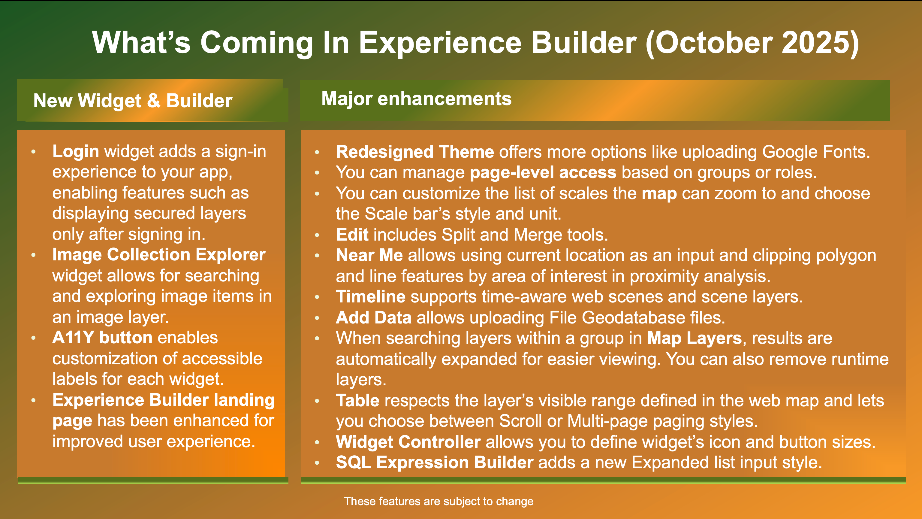

A preview of the new features in Experience Builder for the October release of ArcGIS Online, scheduled for late October 2025. We'd like to highlight the new Login widget, redesigned Theme, accessible labels in each widget setting enabled by the A11Y buton, , and parity features with Web AppBuilder such as Split and Merge tools in the Edit widget.
