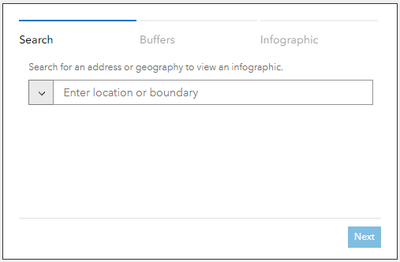

Workflow mode
Workflow modeWorkflow mode
  • This mode allows searching for a location or a geography boundary, defining the buffer type (rings, drive times, and walk times) for point locations, and then running any infographic from the list.
  • You can pair it with a Map widget to see the locations or geography boundaries you define on the map.
  • You can customize each step of the Workflow mode by configuring the Customize searchCustomize buffers, and Customize infographics options. Note: At least one step must be turned on for the widget to work properly.

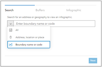

Geography boundary search
Geography boundary searchGeography boundary search
  • You can make the geography boundary search available in Workflow mode for your users.
  • In Preset mode, this option is available to you, the ExB app creator, under Set a location.
  • By default, the search results return both point locations and geographies (All), point location on top and geographies below.

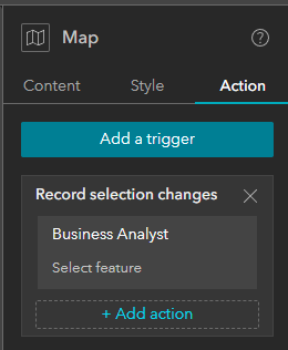

Trigger actionTrigger action
  • The BA widget now works with other ExB widgets that support action trigger (record selection changes).
  • You can configure action trigger on Map, List, Table, and Search widgets that contains point or polygon features and use the record selections from these widgets as input features to run infographics in BA widget.
  • In Workflow mode, the selected feature from the supported widget will be automatically used as an input to run infographics on.
  • In Preset mode, the infographic will automatically update when there is a record selection from the supported widgets.

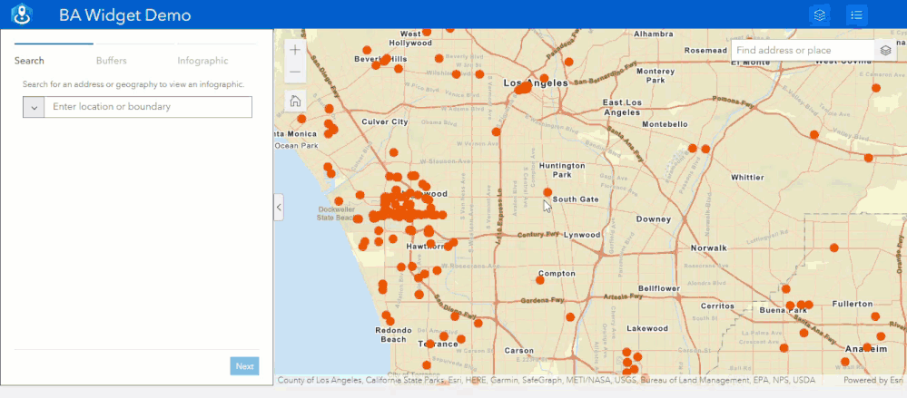

  • Here is another example with a Map widget and a Workflow mode of the BA widget. The widget automatically recognizes the selected zip codes and business locations from the map and provides the next available steps before running infographics.
Map widget with Workflow mode of BA widget (Polygon feature selection)Map widget with Workflow mode of BA widget (Polygon feature selection)
Map widget with Workflow mode of BA widget (Point feature selection)Map widget with Workflow mode of BA widget (Point feature selection)

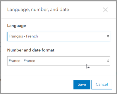

Localization Support
Language and number formatting supportLanguage and number formatting support
  • The BA widget now supports your organization or profile language and number format settings.
  • For countries with localized datasets (Esri Japan and Esri France), geography boundary search is also supported using the selected language.

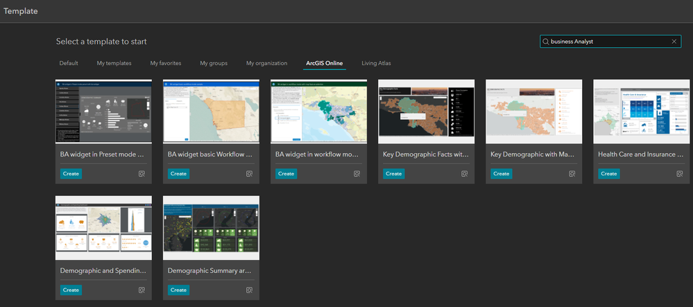

Sample ExB templates with BA widget
Sample ExB templatesSample ExB templates
  • If you are looking for some ideas before creating your own ExB app with BA widget, check out this great sample templates.
  • To get started, go to Experience Builder, and click + Create new. Click on the ArcGIS Online tab and search by Business Analyst key word.
  • All sample templates contain notes explaining the use cases and configurations. We will add more in the future.
