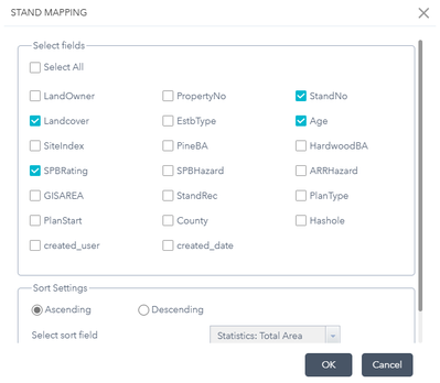

I'm having a bit of a hard time understanding and configuring this widget. In WAB, we used to be able to select the fields we wanted to include in the report for an area of interest, and it would return a list of all the selected field values within that area. Please see the attached screenshots.
Select fields for the report:
This refers to when the client opens the widget—they are able to choose the fields they want included in the report. In this example, we selected four fields.

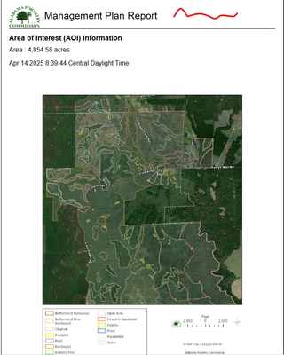

Output Report:
The area where I’ve drawn a red line above the map is a customizable section—we can add custom text there.
We can also insert our company logo, but that’s done during the widget configuration stage.

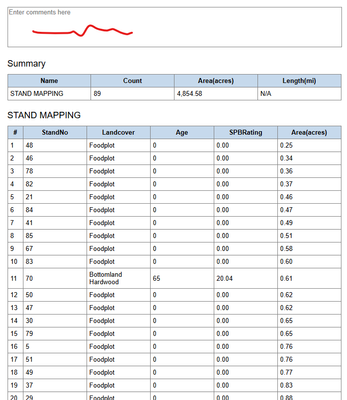

More of the Report:
In the area marked with the red line, we can include a brief summary.
Also, importantly, if you look at the report list below, it displays the values for all the fields and its values selected by the client.
If these things are possible is there a way, I can configure it to do that for our users?
