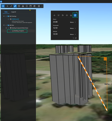

I can't seem to figure out how to measure from points on extruded features.  Differences in elevations from one feature to the next, distance from the z value to the terrain, etc. Is this possible?
Sharon_MU
Hi @Jay_Gregory

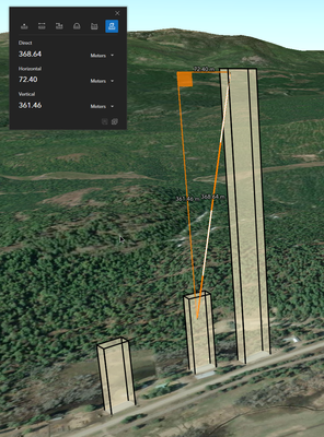

I think it works when measuring from terrain to the point on the extruded building or points between extruded building. Please check the following screenshots of my testing.
Please feel free to let me know if any further question.
