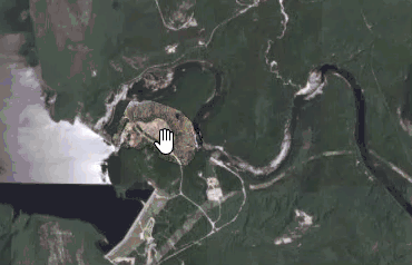

It’s been a while since we last connected — I’m glad to share that this issue has been fixed in the coming version ArcGIS Earth, V2.4.
I've included the screenshot of the testing data you provided previously.  Just to give you a quick preview.
Stay tuned for the new version ArcGIS Earth V2.4!

Sharon_MU
Hi @GeoffroyRicher-Lalonde ,
