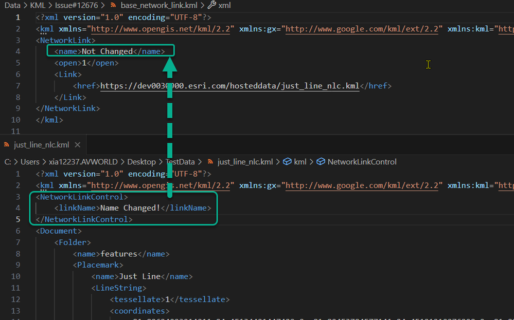

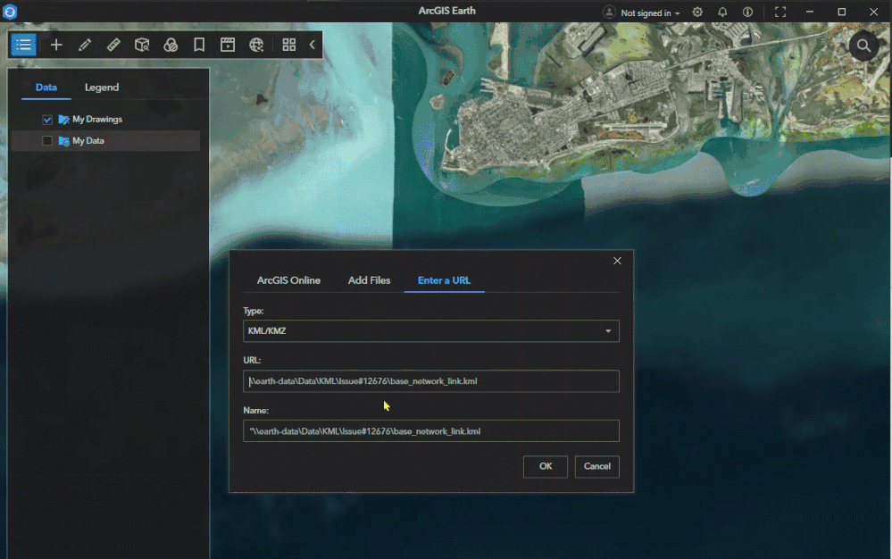

Hi @BillClark,
Thanks for the prompt feedback of the Early Adopter version 2.3!
I double checked on my end, and find currently refresh of `<linkName>`, `<linkSnippet>`, and `<linkDescription>` are actually supported by ArcGIS Earth. As you may have found, it supports pure Text String only so far,  the rich style is just ignored.
See the example as following:
The name of the network link node is changed from "Not Changed" to "Name Changed!" after refreshed.
 From the KML coding aspect:

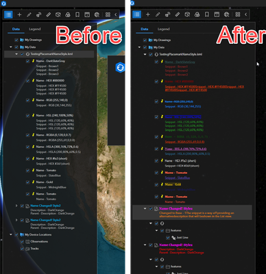

Hi @BillClark , it's been a while since we last connected.  I'm delight to share some updates on this topic.
In the coming ArcGIS Earth V2.4, the complex style of KML Name, Snippet, Description, linkName, linkSnippet, and linkDescription are fully supported.  This means ArcGIS Earth will now honor these predefined styles directly in the Table of Contents (TOC).
I’ve included a screenshot of a few testing examples from my side for reference — just to give you a quick preview.  Stay tuned for the new version!
