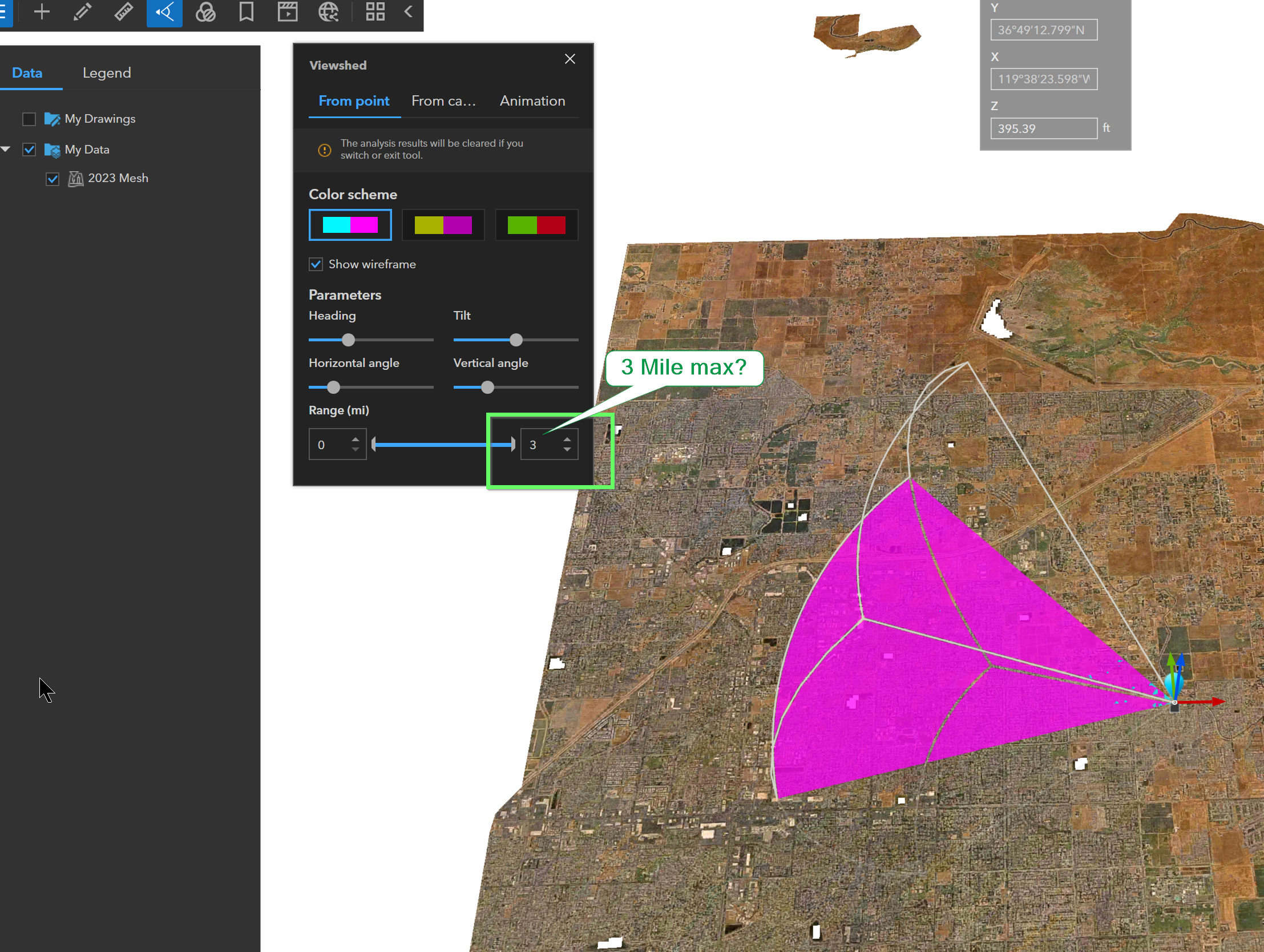

How can we increase the 3 mile (5000 meters) max in the ArcGIS Earth viewshed parameters?
728
04-17-2024 09:06 AM
BillFox
MVP Notable Contributor
https://doc.arcgis.com/en/arcgis-earth/use/interactive-analysis.htm#ESRI_SECTION1_0022B6FA906E4B18B7...
Viewshed parameters
Heading
The heading of the viewshed. Values range from -180 to 180 degrees.
Tilt
The tilt of the viewshed. Values range from -90 to 90 degrees.
Horizontal angle
The horizontal angle of the field of view. Values range from 1 to 360 degrees.
Vertical angle
The vertical angle of the field of view. Values range from 1 to 360 degrees.
Range
Specifies the minimum and maximum distance from the observer. Distance ranges from 0 to 5000 meters.
Bing_AnChen
Hello @BillFox ,
Thanks for sharing your thoughts with us. Currently, we cannot edit the limit neither on the User Interface nor in the config file. We will consider bringing users an approach to extend the maximum range in the close release. I'll keep you updated as soon as we make some progress.
Thank you!
Bing'An
