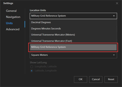

Hello @jonesd92 ,
ArcGIS Earth Desktop has supported MGRS for loading and coordinates transformation. Please switch the location unit to MGRS in settings - Units - Location Units before adding the MGRS data to have a better view.
