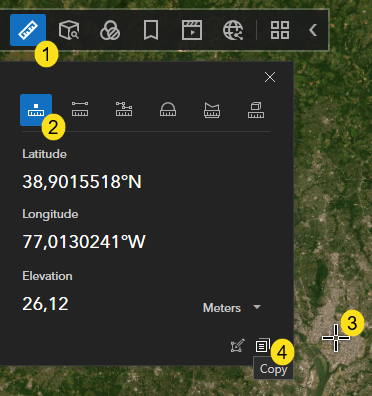

Hi @KraftDurchSuppe . You can do this :
  1. Measure
  2. Point
  3. Click on the scene
  4. Copy to clipboard

GeoffroyRicher-Lalonde
  1. Measure
  2. Point

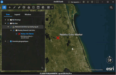

If you are OK with the third party http://www.nearby.org.uk/, you could use their Network Link Echo. This KML Network link auto refresh after the camera stops and put a red X at the center of the scene. Right click on the scene where you want to obtain information and choose Near to center on this point. When you click on the red X, you will have every possible information you want about the scene. You can then copy/paste text from the popup window.

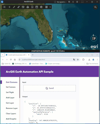

The hardest way would be to activate the ArcGIS Earth Automation API and to develop a tool that can fetch and copy the X and Y position of the cursor. You could do that with HTML, CSS and JavaScript, using the ArcGIS Maps SDK for JavaScript. Good luck!
I just had this thought : you don't have to develop anything to work with the Automation API. Just activate it and use the http://localhost:8000/sample/index.html URL. Right click and choose Near to center the camera. When the camera flight is done, click the Send button for the Get Camera method and you will get your coordinates.
