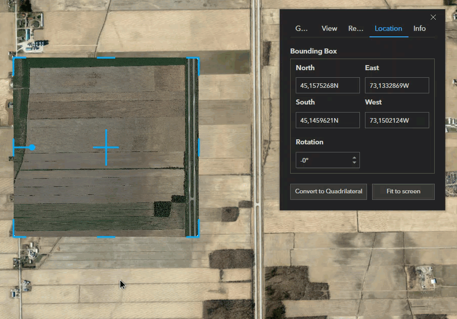

Using ArcGIS Earth 1.17.
There seems to be a bug with the Convert to Quadrilateral tool in the Ground Overlay. Using the tool with no rotation will apply a -90 rotation :

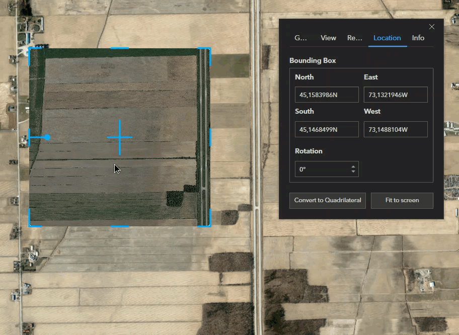

To correct this problem, a user may first apply a 90 rotation :
Due to the 90 degrees rotation, the order of the corners will shift from :
This is important for users who want to georeference their images with known corner coordinates.

@GeoffroyRicher-Lalonde Thanks for pointing out this bug, I think we have fixed it on ArcGIS Earth 1.18 which was released on 3 Mar. Please give it a try.
Indeed, it is corrected in ArcGIS Earth 1.18. Many thanks!
