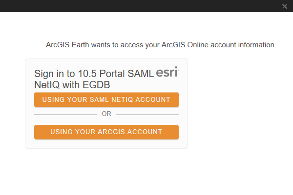

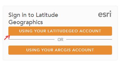

XuewenZhang
Hi Ben,
If you have an account of Portal using SAML authentication. You can sign in to this Portal without configuring anything in ArcGIS Earth V1.2. There will be a login prompt for you to input your account, like the attached picture.
Best,
Xuewen
