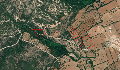

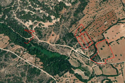

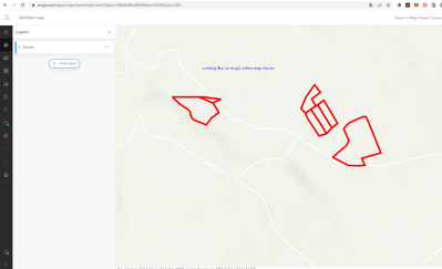

Hello, I created a WMS service on my GeoServer server. I added the layer in this service as a content to my Arcgis Online account. I can view the layer through Arcgis Online Map Viewer without any problems. However, when I log into Arcgis Earth App and add the WMS layer from my content, the images appear incomplete and incorrect. When I completely remove the layer from my Arcgis Online account and add it again, the missing parts are fixed. But layers are added regularly from an external application. When a new layer is added, the new layer appears missing or not visible at all. But since I know the location of the layer, when I click on that point, I can get information about the layer.

default layers working normally. also my layer is working normally. butwhen I add a new layer dynamically, parts of the new layer lines seem to be missing. When I delete the layer and re-add it to Arcgis Online, or when I open Arcgis Earth the next day, the layers are displayed without any problems.

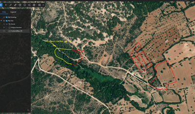

Hi, when I add the format parameter, the layers are displayed without any problems. But there is still something strange. Layers are updated when I disable and re-enable the layer. It doesn't update when I move the map. Also, when zooming back in, the layers don't grow to scale. It stays fixed. I tried watching the network flow with Fiddler. But Arcgis Earth does not allow this.

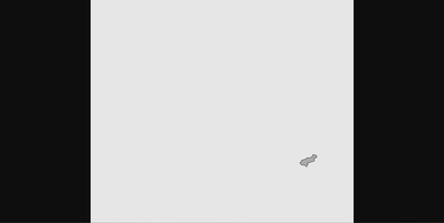

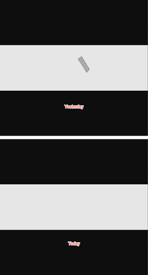

I tried the request you provided above with the web browser today and yesterday, but I got a different result. I can see a polygon yesterday, but I got an empty image right now.
https://gis.cyprusgis.com/geoserver/deeds/ows?SERVICE=WMS&EXCEPTIONS=XML&bbox=3824574.4902976798%2C4...
And I also tested the WMS service on your GeoServer, I got the same result whether adding to ArcGIS Online or adding the WMS directly to Earth. I just see one polygon, is this expected?
https://gis.cyprusgis.com/geoserver/deeds/ows?width=1499&height=1273&bbox=3822132.190649424%2C424192...
For WMS, Earth only renders the image get from the server side, so looks like it is a cache issue on the client or server side. I think it is worth checking the cache configuration of the WMS service on GeoServer.
