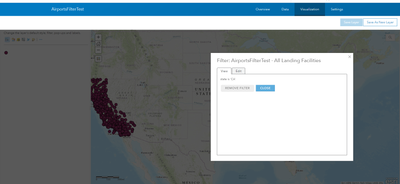

So to create the filtered feature layer, I go to the item in Portal, and click on the "Visualization" tab.  Set a filter and click "Save Layer".  See screenshot.  This is a great way to curate many layers of feature services folks can add to maps, without everyone having to set their own filter on each map.  For example, if I added this layer to a web map, the filter I set on the layer in Portal would be honored, without having to readd the filter from the MapView.  However adding this layer to ArcGIS Earth, the filter is not honored.  It just shows everything from the feature service the feature layer is pointing to.  Does that make sense?

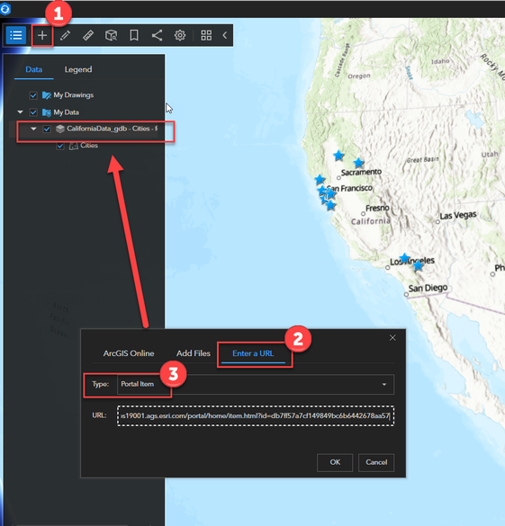

Following the same steps with yours, I created a filtered Feature Layer (also changed the symbol) and saved it in the portal.  Please see in the screenshot for details:
Then I added this Feature Layer to ArcGIS Earth via 'Enter a URL' - 'Portal Item'.  The URL needs to be the Portal Item URL, which you can find in the address box in the web browser.
The filter of the saved Feature Layer item could be honored in ArcGIS Earth.  Actually, not only the filter, but also the symbol style is honored.
