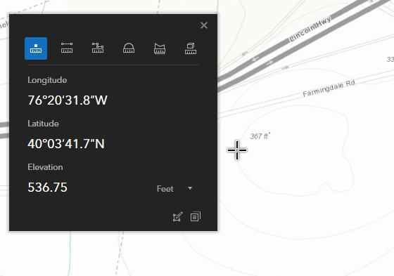

First, the elevation profile functionality in ArcGIS Earth is really pretty cool.
I have been checking elevation values in ArcGIS Earth 1.9 versus other data sources and the values appear to be off substantially. For example, I get values of around 350 feet from both USGS DEMs and the Topo basemaps for a location in Lancaster, Pennsylvania that are reported as 530 feet in ArcGIS Earth's profile.
Any ideas what may be happening here?

I suspect your elevation exaggeration is not set to 1 under 3D effects.  Please check your settings.

The source of the elevation profile is the terrain you used in the Terrain panel. It could be an online elevation service or a local terrain file. The default terrain is https://elevation3d.arcgis.com/arcgis/rest/services/WorldElevation3D/Terrain3D/ImageServer
If there are several terrain files available in your Terrain panel, then the first terrain on the top will be used to generate the elevation profile.
I've compared several terrain sources and the values are consistent. Could you help to check is your elevation exaggeration set to 1 under 3D Effects? Just like Mervyn Lotter‌ mentioned.

I checked and changed the exaggeration to 1 and now I get the expected results.
BUT, I would disagree with this functionality. The exaggeration should be applied to the visual display and NOT the reported elevation value of a location in a profile or location measurement.
