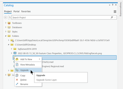

While troubleshooting this issue, looking at the slpk file in Pro 2.9.6, I right-clicked on it to check properties and noticed an option on the right-click fly-out to “Upgrade”.
ArcGIS Pro 2.9
Upgrade Scene Layer (Data Management)
https://pro.arcgis.com/en/pro-app/2.9/tool-reference/data-management/upgrade-scene-layer.htm

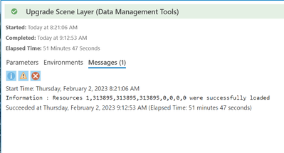

I gave that command a try and it completed successfully in about an hour.
Then we were able to view it in both Pro 2.9.6 and Earth 1.17 (1.17.0.3651)
  • The original slpk file is 131 GB.
  • The new output slpk file size is 240 GB.

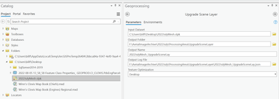

Step 1)
Step 2)
Step 3)
Step 4)
