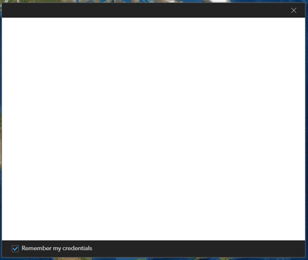

Is anybody experiencing the blank screen when trying to log into portal via enterprise login?

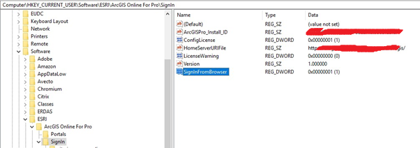

This experience is very very similar to the known issue seen in ArcGIS Pro 2.7 when not using the browser to sigin.
I'm hoping there is registry setting & portal redirect that can be applied similar to the fix in ArcGIS Pro.

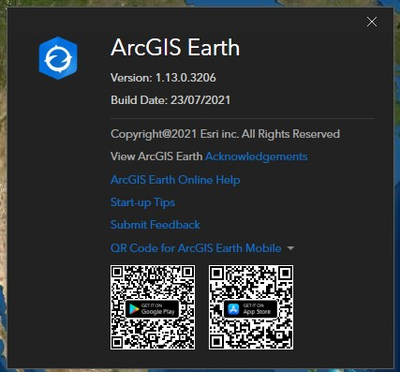

@AnthonyRyanEQL  Please confirm if you are using  ArcGIS Earth of 1.13, we have improved a lot about the login-in ever since. If your issue is still existing in 1.13, could you please give us more details about your Portal and SAML?
AnthonyRyanEQL
WillyLi,
This is the version I'm using. I downloaded it on Aug 5th 2021
Our Enterprise deployment is 10.7.1 hosted in AWS using Azure AD for SAML. Is there anything in particular you need me to find out?

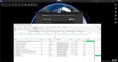

Hi @AnthonyRyanEQL  We can't reproduce the blank screen in our testings, it might be related to the login-in control adapting to your network/portal environment issue. When the login window is open, you can press F12  to open the web browser control debugging window to try to find some clues, like below:

I displayed the debugging screen and found a 401 error on the my company's url for ADFS. I went back to the configuration for ArcGIS Pro 2.7, removed the 'SignInFromBrowser' registry setting and monitored the http traffic. The same blank signin screen & same error in the url occurred in ArcGIS Pro signin as it did for ArcGIS Earth
