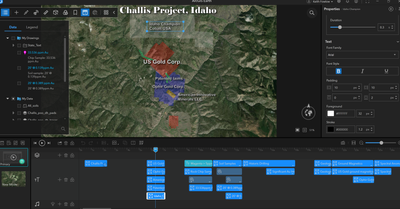

At this time I am not able to make a video but I took a screen shot of the issue. As you can see, I made a few labels for polygons. These polygons are part of their own layer in the video. Originally, I had the labels generated by the data layer. But I wanted to emphasize one label over the others. So I had to resort to make individual video labels. Now as you can see from the screen shot, I made the labels but I am not able to align them to the center. On the right of the screen shot are the properties of one of the labels and there is no option to align the labels. I'm using the most recent version of ArcGIS Earth. When I turn on the labels in the data layer, they will center justify the text if need be. But there is also no option to change the alignment of the text. It is a conundrum. Do you think this is a software issue and alignment was not added? Do you have a work around? I can think of one but it will be time consuming and make my additional layers which I was hoping to avoid.
