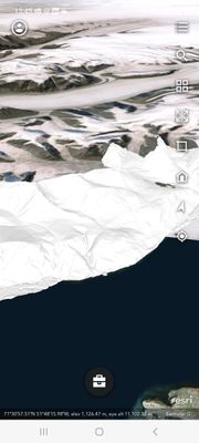

This is regarding an issue we have with the ArcGIS Earth app for Android. We are trying to use a local SLPK mesh file with textures on our mobile phones, which has worked quit well before, but now when we are trying to add them to the scene in the app, there are no textures anymore.
Is this an issue you are aware about or has there been any changes to handle slpk-files?

Thank you @JoeZhengLi. We are using the android version of ArcGIS Earth v.1.7.1 build 1461 from Google Play Store. We have tried the mesh on a Samsung Galaxy S20+ 5G and Galaxy A51. Both of them are not showing the texture, but has worked before.

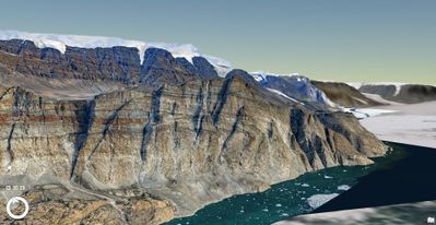

In ArcGIS Pro, the slpk-file works fine as seen on the screendump below.
