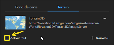

Here is a workaround : turn off the Terrain3D elevation service in the Terrain menu :
Your labels will be visible in Export 🙂
