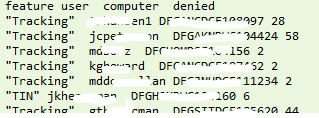

Couple questions.....what does the number under the "v"  column represent?  Number of times the person was denied??
And, is it possible to get the date/time stamp?
Sample of my output
