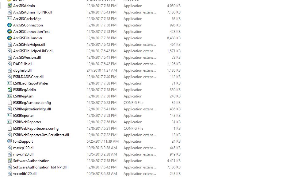

Please send me screenshots of two things:
1. The files listed in the x86 Common Files\ArcGIS\Bin folder.

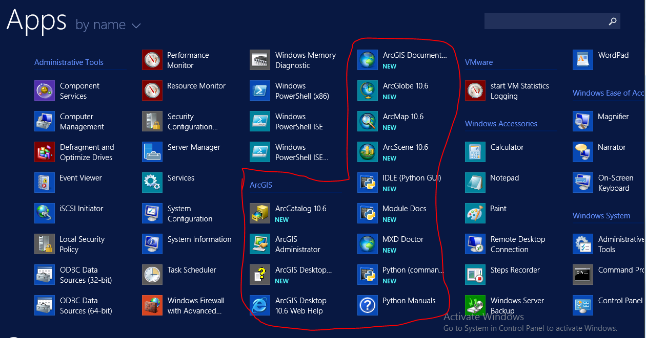

From the control panel
From the program files

LaureneKoman
The files look good and the correct Cruntime was installed by the ArcGIS Desktop setup. We can’t repro this issue on clean Windows Server 2012 R2 machines so I don’t think it’s an issue with that OS, just something specific to this particular machine.

LevinConway
Celine,
We ran into the identical problem on WS2012R2 Standard
THANK YOU for posting your screenshot as it clued us in to the solution.  The Visual C++ Redistributable (x86) 14.10.25017 installed by VMWare Tools appears to trigger the error with the ArcGIS Engine 10.6 installer when run on WS2012R2.  I downloaded a newer redistributable (14.13.26020) and installed it over the top of the existing one, then ran the 10.6 Engine installer and it installed without the error.  ESRI will likely need to modify their installation package but in the meantime the updated redistributable can be downloaded here:
