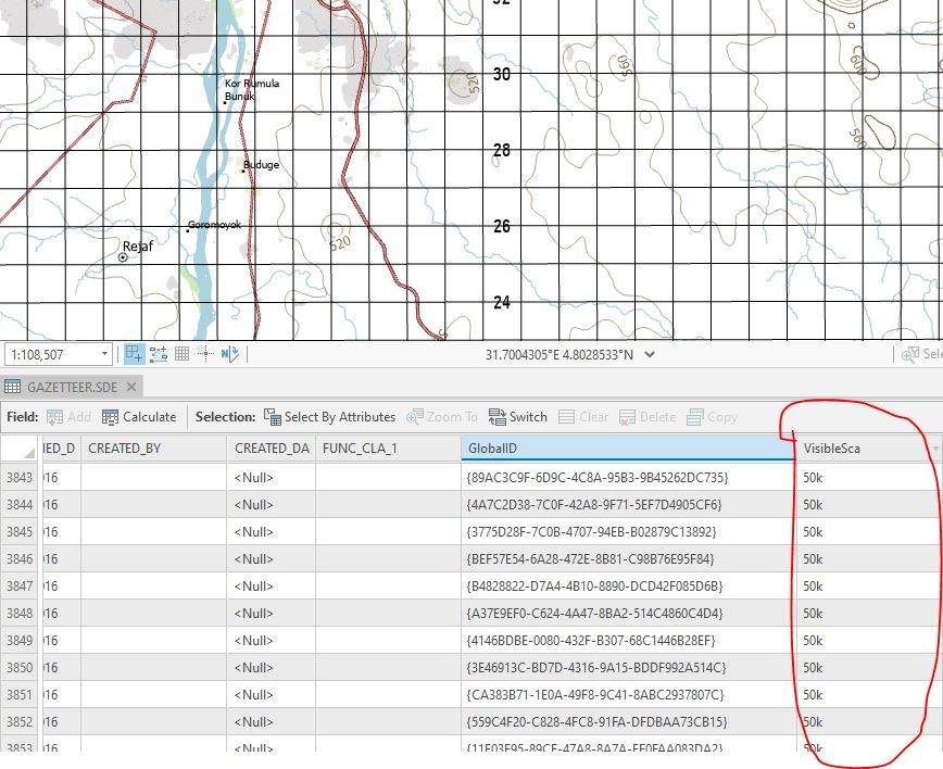

chhayvanchha
Sir,
Pls find the attached which is the attribute, someone did with attributes can be displayed in 100K or 50K visible scale, that's awesome but do not know how to do so.
Regards,

chhayvanchha
Sir,
What I want to say is for one particular area which has a lot of village names (points) there, so how village points can be determined automatically in term of particular scale, which generate by any tools.
Regards,
