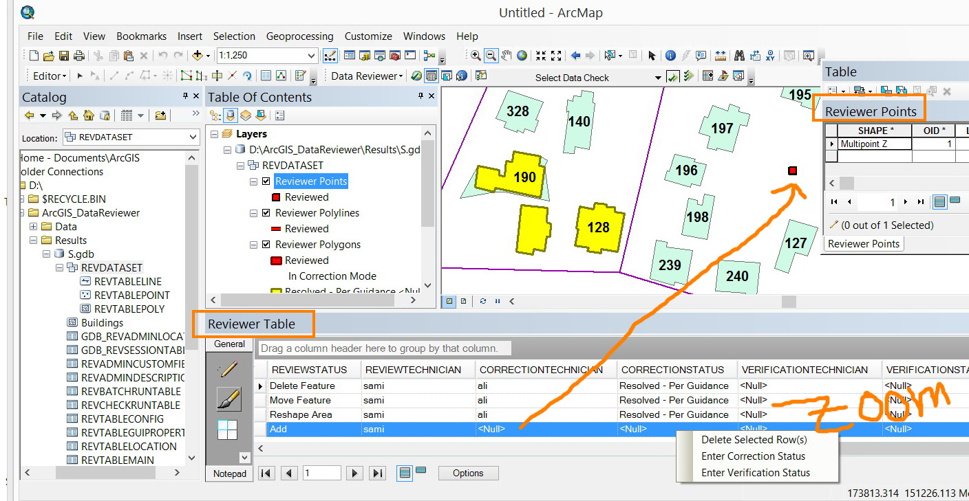

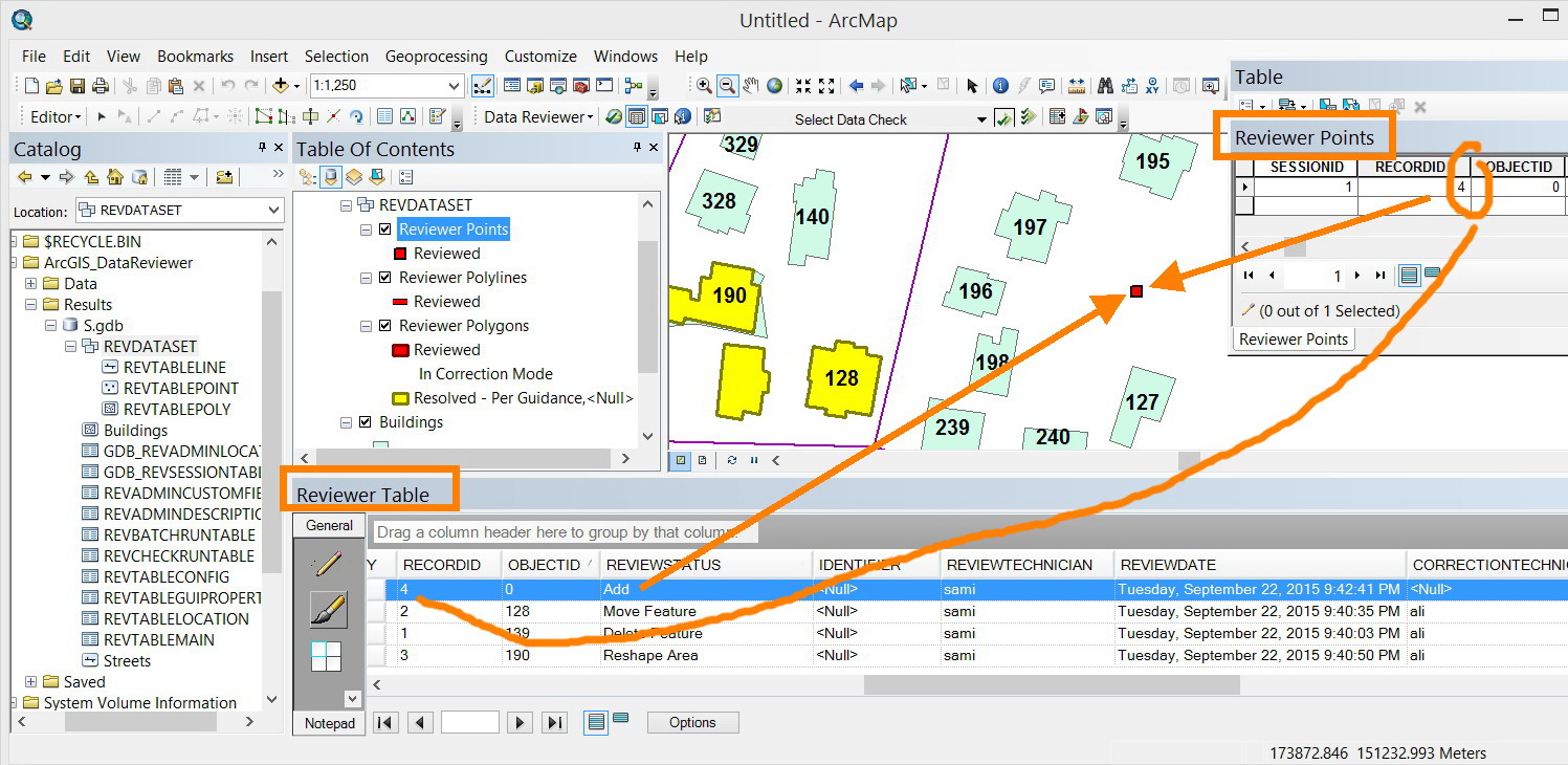

It appears that there is no option to zoom to features that have “add” as “review status” then how one can go to that location to perform the add? Should we use the “reviewer points” table?

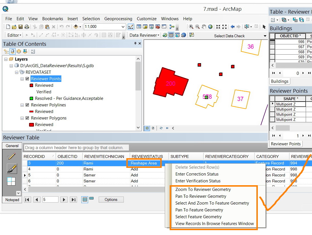

If you select a record in the reviewer table, you can Right Click the record, Select Feature Geometry.  Then in the Attribute Table, Zoom to Selected Feature.
This is the only way I know of doing it.

I just realized you can double click a record in the Reviewer table and it zooms you to the feature.

  • In case of “add” review status, there is no option “Select Feature Geometry”
  • Double clicking the record will zoom to the point. However, in case of having multiple points, one will never be able to recognize which record belongs to which feature! There is no selection
