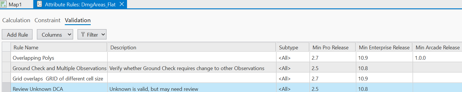

In creating a list of rules for my data  I am finding that the 'Feature on Feature'Ready to Use rules are working well. However when I add Ready to Use "Query Attribute" rules to my Attribute Rule list for error conditions that I know are present in the data. , Only the first "Query Attribute" rule authored and tested  will find the appropriate error conditions, Any additional "Query Attribute" rules are not found by the error inspector.  I have tested this in multiple ways. switching which of my 'Query Attribute" rules run first in my Attribute Rules list and the behavior seems consistent. Only the first "Query Attribute" rule runs correctly when Validating.
In the screenshot below. "Ground Check and Multiple Observations" and "Review Unknown DCA" are 2 different "Query Attributes" . If ""Ground Check and Multiple Observations" is created/added to my Attribute Rules list . It will run properly in Error Inspector, but  "Review Unknown DCA" will not. If I reverse that order and define "Review Unknown DCA" before ""Ground Check and Multiple Observations" the "Review Unknown DCA" will validate correctly in error inspector and none of the "Ground Check and Multiple Observations" conditions are found by the error inspector.

 These rules were run against a local file geodatabase.
Unless a coincidence I think I was able to resolve the issue by removing an Attribute Filter query used by the  "Ground Check and Multiple Observations" rule.  I originally speculated that using an Attribute filter might speed the performance. On a hunch  I removed that Attribute filter  and simply added that query  (Observation_Count = MULTIPLE)  as an additional clause in the Search Goal. After that change all my Query Attribute rules in my list/batch ran successfully ( see screenshot below for the successful update) .
It seems like there was some glitch in the software that was holding onto that "Observation_Count = MULTIPLE" attribute filter for all of the Query Attribute rules  even though my other Query Attribute rules only used Search Goals. An unintended input filter of "Observation_Count = MULTIPLE" would  explain why my other Query Attribute rules did not detect the expected error conditions.
