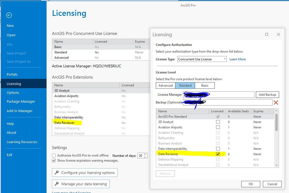

Angiex__1
But I have the license enabled but i dont see the Attribute check in the Data design
RichardDaniels
Honored Contributor
ensure the license is selected, not just available on your server. DataReviewer_Licensing.JPG
