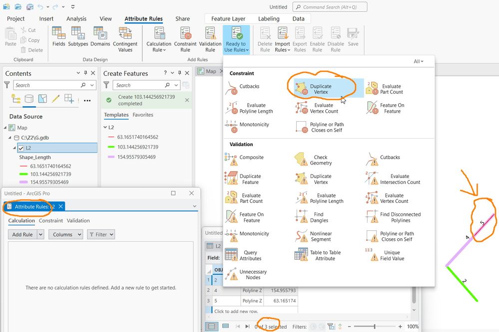

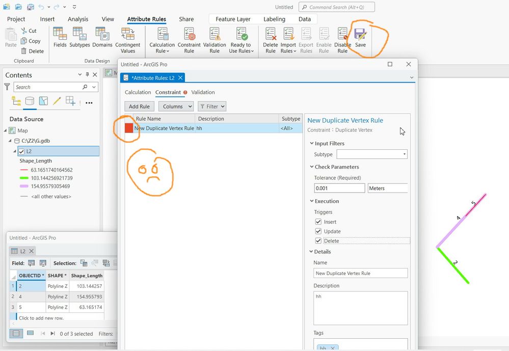

As per the screenshot, the “duplicate vertex” attribute rule fails to be saved
What could be the issue here?

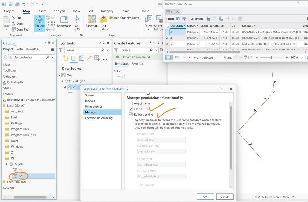

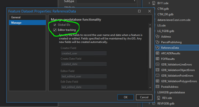

This is likely because the editor tracking and global ID fields are not enabled on the feature class, you might want to confirm this boxes are checked by right-clicking on the feature class to enable the context menu and select the Manage option:
Example

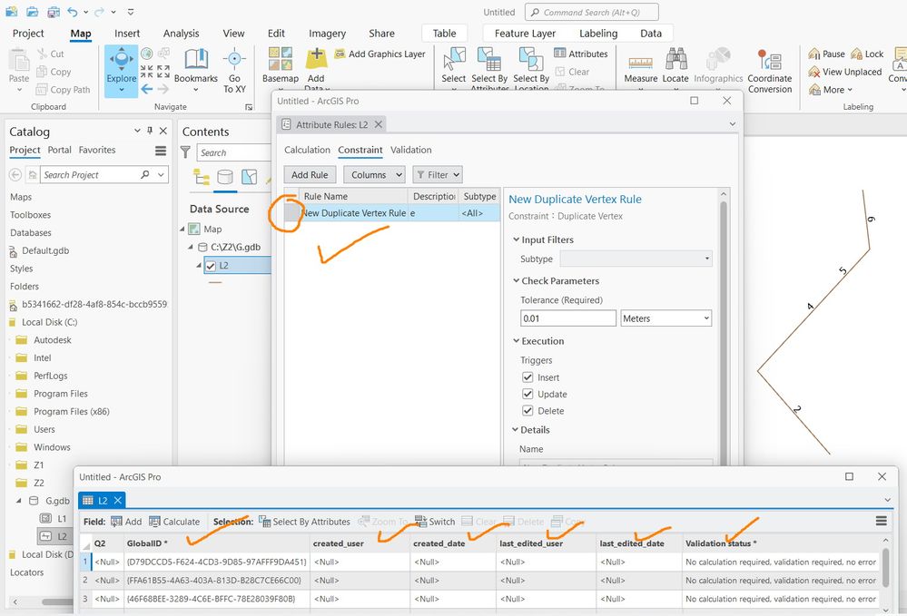

Thank you Francisco. It works fine
