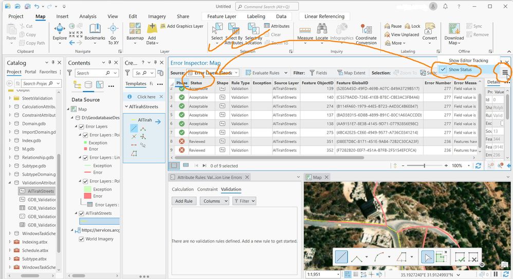

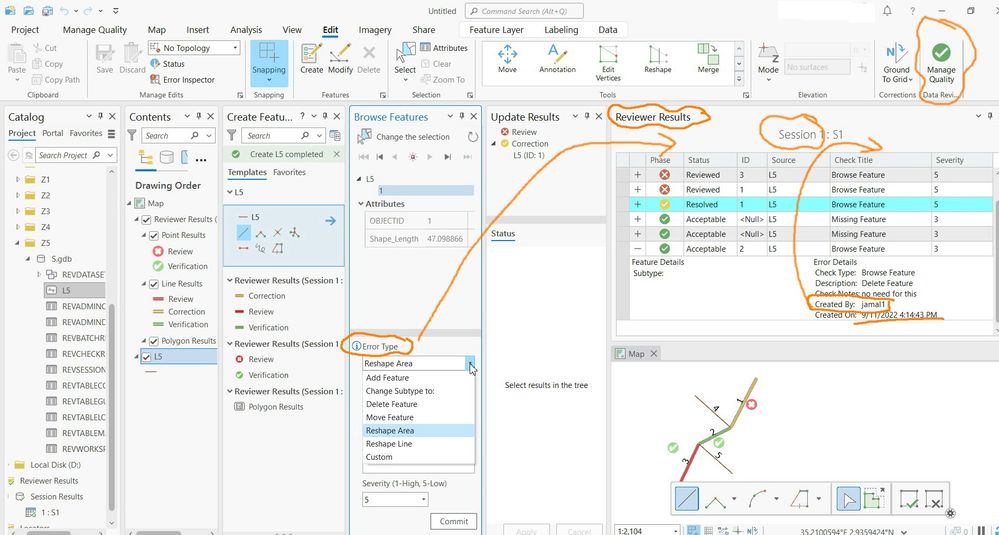

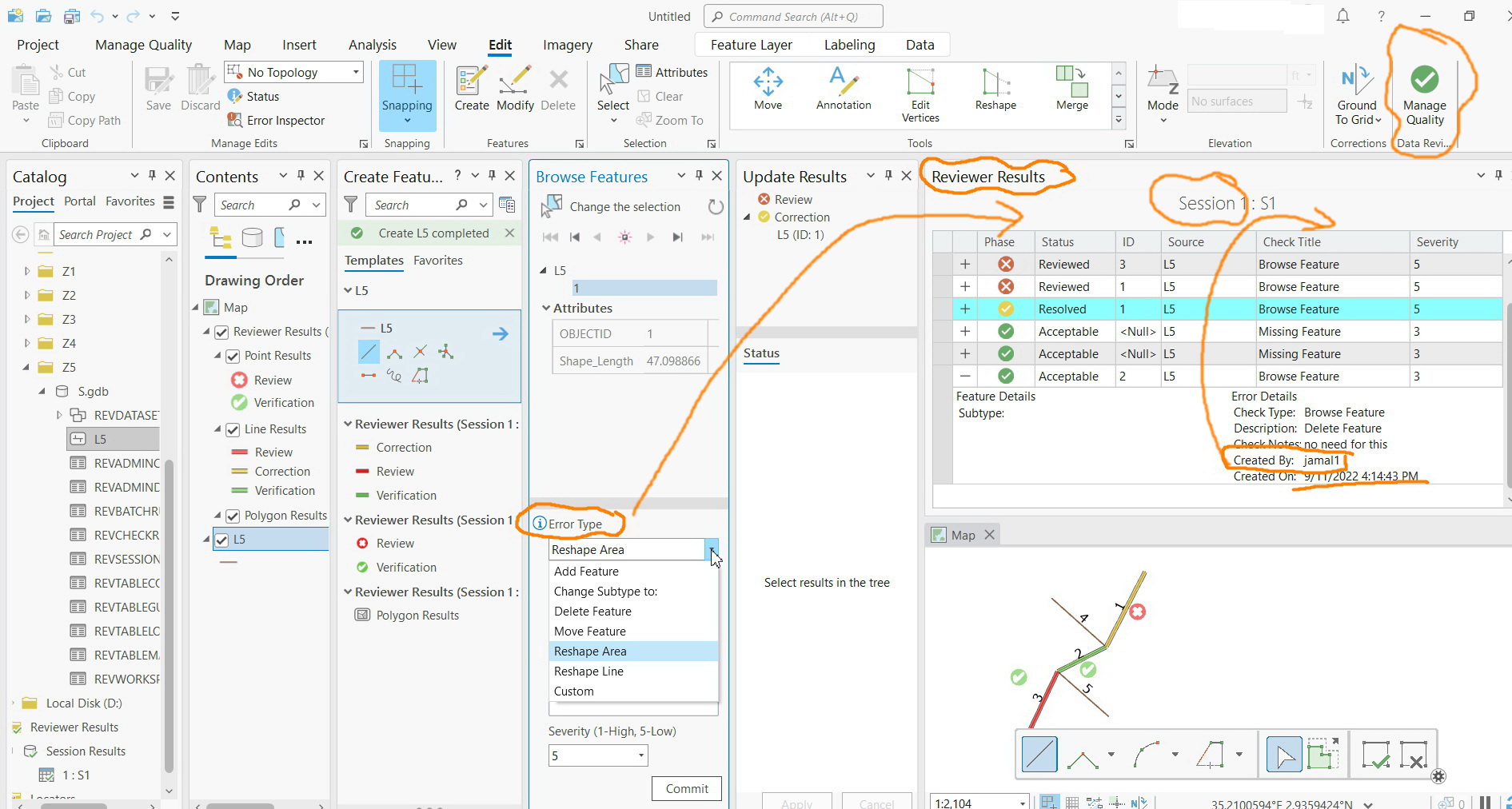

I couldn’t figure out how to display the “creator” and “error type” fields in the reviews results session table when working with “manage quality”

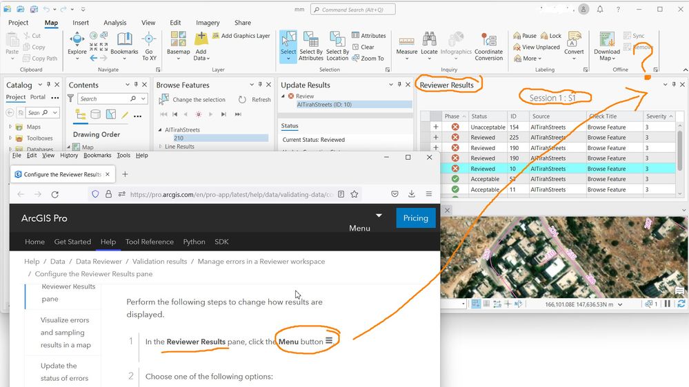

The development team has reproduced this workflow in ArcGIS Pro 3.0.1 and found that the issue is related to the missing Menu GUID-480AB849-6E7F-4CE6-B703-22269B8A0D66-web.png command in the Reviewer Results pane. Here is a topic that outlines how to configure the Reviewer Results pane to display different error types and their related attributes.

How to manage to get these fields displayed as the menu button is still missing? This menu is available for the “error inspector” pane
