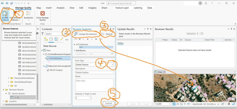

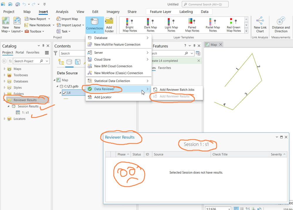

I couldn’t figure out how results are added to the data reviewer session window

Here is a topic that outlines the workflow for adding Reviewer sessions to an ArcGIS Pro project.

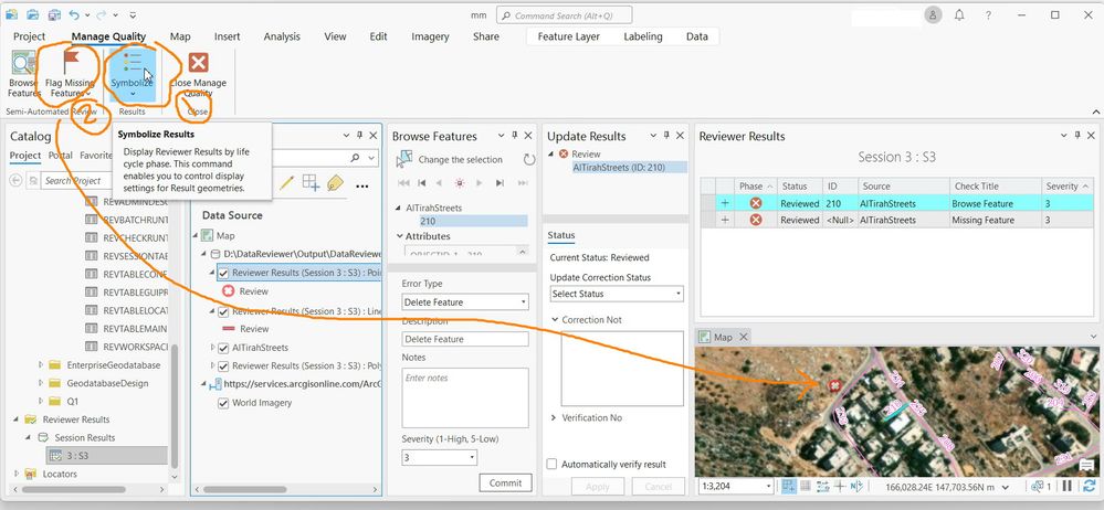

Records are going to be populated in the reviewer results session table as features are selected and committed by the “browse feature” tool. Also, the records of flagged location will be also displayed in the pane
