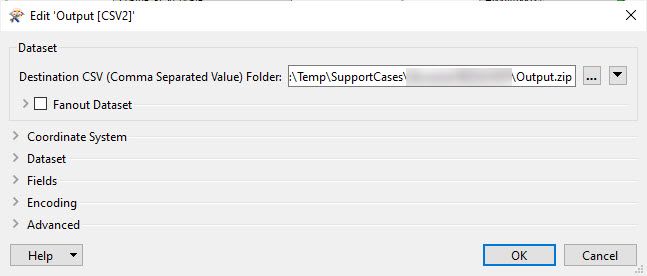

For my example I had to get a little more creative.  The first challenge wasn't around parameter types, it was zipping multiple CSV outputs per input.  Many formats in FME technology support conversion to a zipfile.  The way to do this with CSV data is supply a zipfile name as the last part of the output dataset "folder".  Here is my ETL tool workspace:
Excel to CSV With Feature Type FanoutExcel to CSV With Feature Type Fanout
And here is my output "folder":
CSV Writer Folder Path With Zipfile PathCSV Writer Folder Path With Zipfile Path
If you look closely at the workspace you'll see I trigger a feature type fanout based on an attribute value - see the CSV File Name is an expression @Value(Environment).  This gives me one output CSV file per unique attribute value.  In the writer parameters I specify a path ending in "Output.zip".  In operating system terms it is a file but to Workbench (and ArcGIS when calling the ETL tool) it is still a folder.

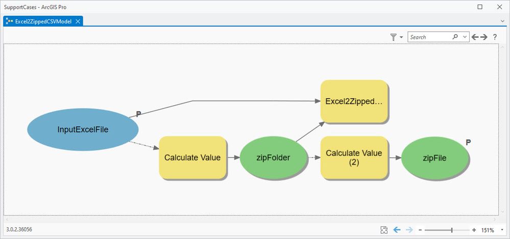

To make everything work as a web tool I need correct ArcGIS parameter types, folder input and file output.  Folders do not work as outputs.  I also want to specify a scratch file location for the output so that the job environment can see and return the data.  The trick is to wrap the ETL tool in a model and set paths and parameter types explicitly.
The two Calculate Value model tools are key.
The first one creates a zipfile path in the job scratch environment but casts it to Folder:
Create Scratch Folder Zipfile PathCreate Scratch Folder Zipfile Path

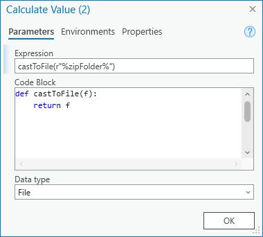

The second one takes the same path and casts it to File:
Folder Cast To FileFolder Cast To File

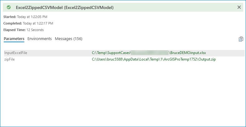

Then everyone is happy.  I can run the tool in Pro, it uses the local scratch environment, then I can share the result as a web tool and it will use the ArcGIS Server job scratch environment at run time.
I get my data back in Pro and use Web AppBuilder against the web tool.
Web Tool Output In ProWeb Tool Output In Pro
