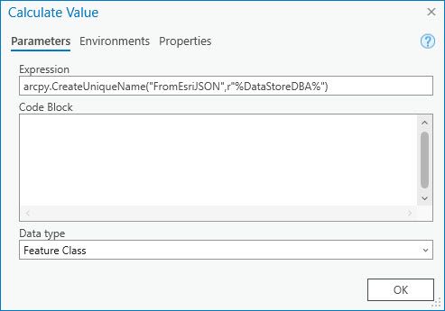

The first Calculate Value model tool downstream of the workspace variable generates a unique output  feature class name for the target geodatabase.  The only notable thing is I make sure to use raw string processing for the workspace variable (r"%DataStoreDBA%") because on the server it is a complex path with metacharacters like "\a" that would otherwise be interpreted.  For example:
C:\arcgisserver\directories\arcgissystem\arcgisinput\EsriJSON2EGDB.GPServer\extracted\p30\DataStoreDBA1.sde\FromEsriJSON0
First Calculate Value ToolFirst Calculate Value Tool

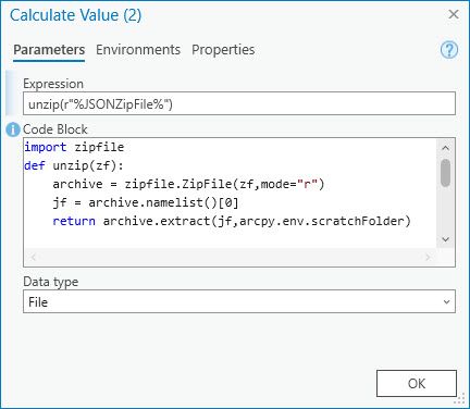

The second Calculate Value model tool downstream of the data file input unzips the data to the scratch folder.
Second Calculate Value ToolSecond Calculate Value Tool
 On the server an example path in the job folder looks like:
C:\arcgisserver\directories\arcgisjobs\esrijson2egdb_gpserver\jf37903613c4f4e5685efc5e0861fdbbd\scratch\FeaturesToJSON_OutJsonFile_Nelson.json

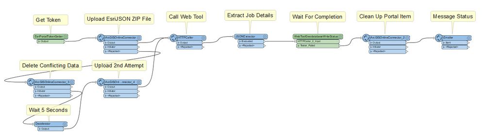

Drum roll please - here is the FME workspace (Main canvas) that calls the web tool:
FME WorkspaceFME Workspace

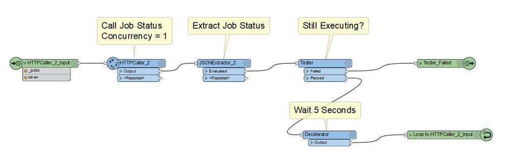

...and the looping custom transformer in the middle looks like this:
Looping Custom TransformerLooping Custom Transformer
Everything is in the blog download (authored in Pro 3.0) but let's step through the FME workspace.  In your real world, FME Flow will be cooking up data to be written to the EGDB.  I don't do that in my sample but you will have to make file-based data to send.  My input parameters are a user-defined zipped JSON file and the web tool home URL (not published, as it is static):
https://dev0015493.esri.com/server/rest/services/EsriJSON2EGDB/GPServer/EsriJSON2EGDB
The first step is to get a portal token, that's the first (green) transformer.  Then the input zip file is uploaded as a portal Code Sample item.  Code Sample items contain a file that must have a unique name per folder, regardless of whether the Code Sample item name is itself unique.  Just in case of a name collision I delete any existing items with the same content name (found by rejection), then upload the input data.
After that it's just HTTP to send each job, a looping custom transformer to wait for job completion, and then I delete the portal item we are finished with and finally email a result message to any interested parties.
