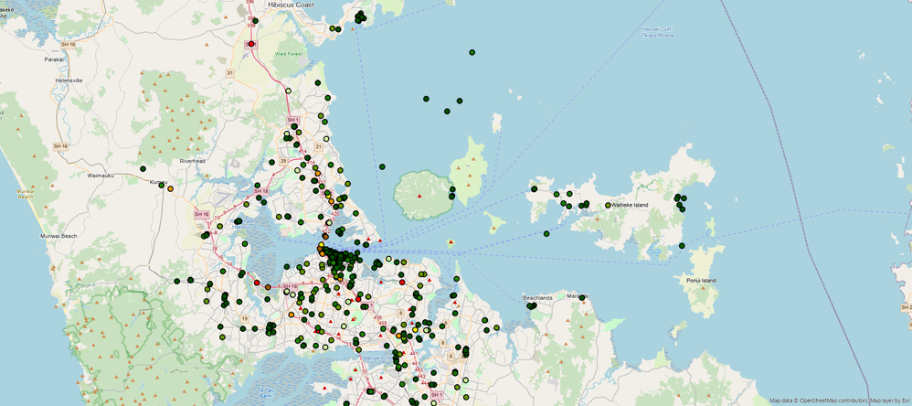

Here are bus, train and ferry positions a few moments ago (early Saturday local time) in Auckland, NZ.
Bus, train & ferry positions in AucklandBus, train & ferry positions in Auckland

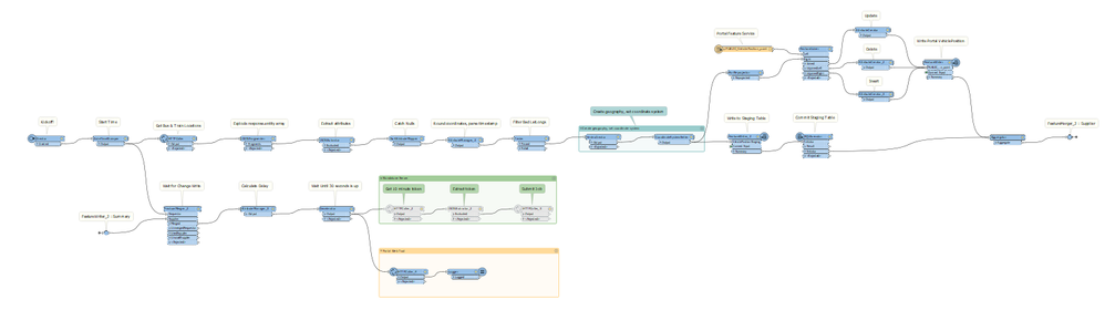

I'll let you surf the tool yourself but basically the upper stream fetches the vehicle data and synchronizes it to the portal and Snowflake and the lower stream waits for this and for 30 seconds to elapse then makes the HTTP call.
The Self Integrating ETL ToolThe Self Integrating ETL Tool
Then just run the web tool once manually and you're off to the races, it will repeat endlessly.  I'm sitting here refreshing my Pro map (no cache on the feature service layer) and seeing the transport fleet move around.

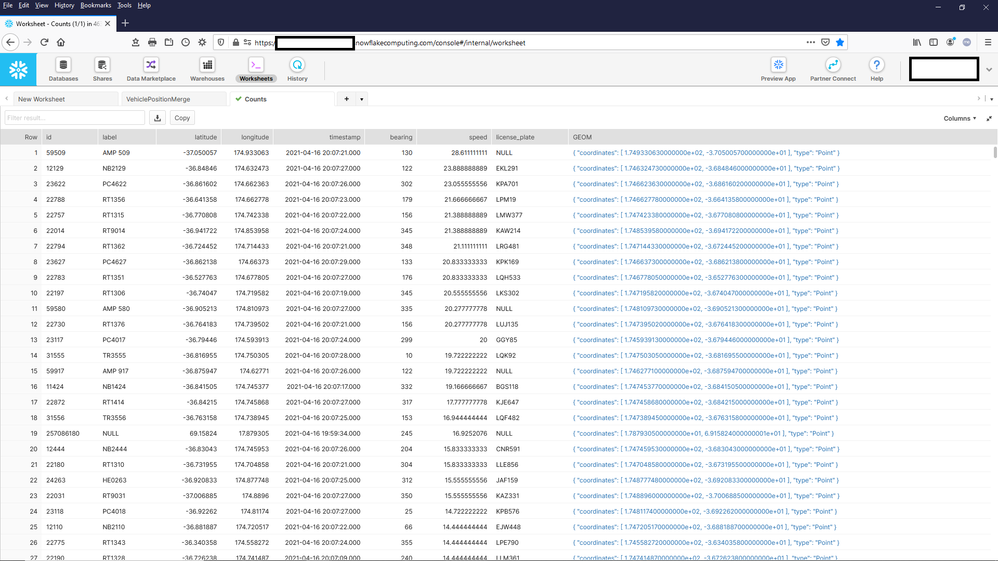

In Snowflake my data is also refreshing:
Snowflake consoleSnowflake console
