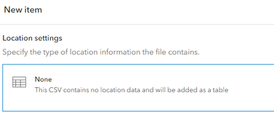

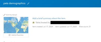

Did you publish it or just upload it? If you simply uploaded, go to the Item Details and hit the publish button. For location, select None.
Once you have a hosted table you can add it to your dashboard.
Then in your dashboard, browse to your hosted table in the Stand-alone layers section.
Publish from CSV

It looks like it wasn't published. I got it working and was able to add it to the dashboard. Appreciate the help on this!
