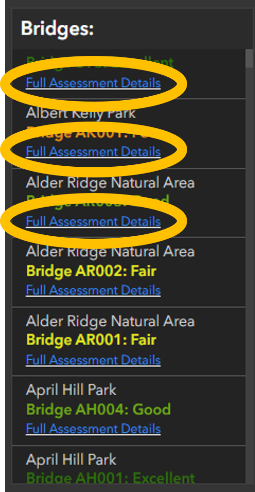

Currently, I have a main dashboard that has hyperlinks (Full Assessment Details) in lists that take folks to a simpler dashboard so they can get specific details on that feature. See below.
The link to view full assessment details takes users to a simple secondary dashboard that contains a map of the features and has URL parameters. The URL parameters are set as feature parameters and are configured to zoom, flash, and show pop-up. I am using the Global ID as my unique identifier for my features.
When I click on a hyperlink (Full Assessment Details) it performs every action I have set: it takes the user to a new tab, opens the simple dashboard, and completes all the actions set in the URL parameters except showing the popup.  It zooms in on the feature and flashes it, but the popup does not display. This is odd because it clearly recognizes the Global ID for the feature and performs most of the tasks set in the parameters.  See the sample URL below:

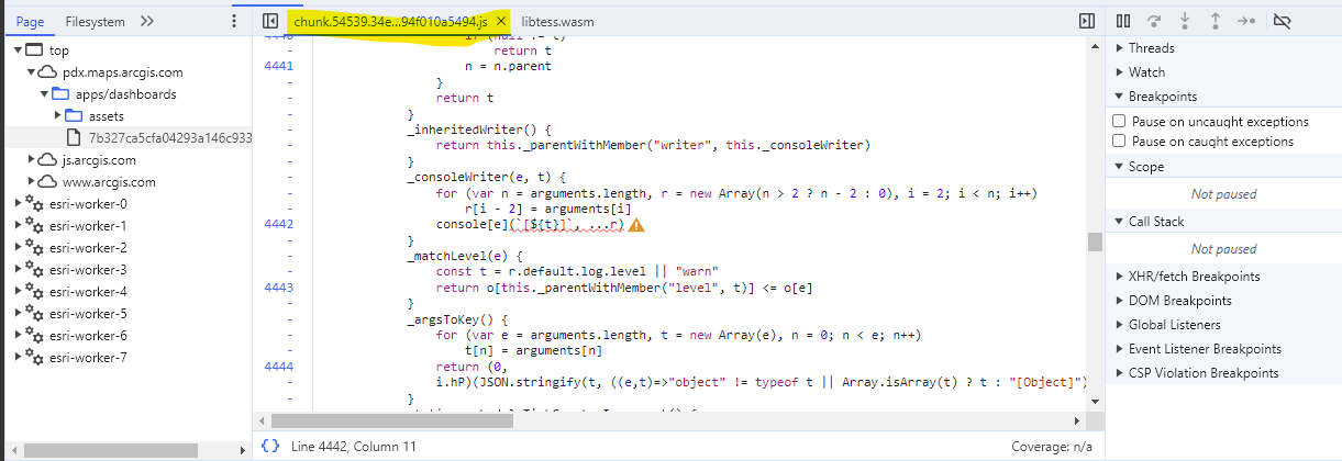

I opened up the developer inspection tools in Chrome and found this error pertaining to URL query parameters (seems relevant):

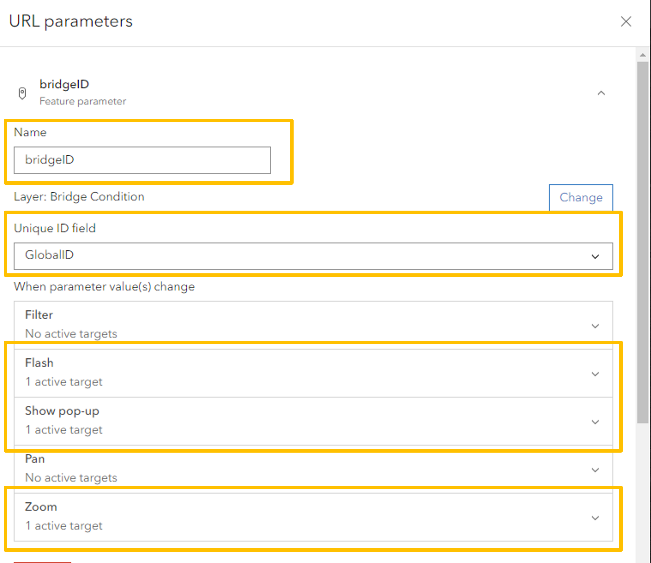

  These are the URL parameters set in the secondary dashboard for bridge features:
