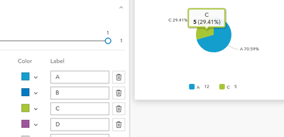

It's interesting, the chart "sees" the other values, but when there's nothing to render for the Pie Chart, it won't include it in the legend.

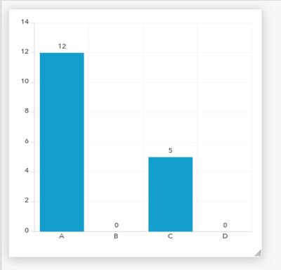

A serial chart will show the empty values, though:
I think it's just a default setting on the pie chart, probably nothing you can do about it without something kinda hacky like making an SVG pie chart from scratch.
