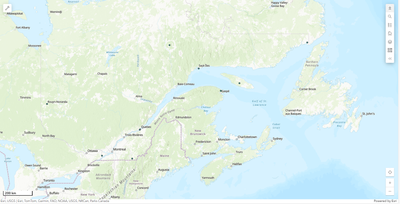

Following the June 2025 ArcGIS Online update:
  • The "More tools" dropdown menu in the top right corner is now expanded on launch, making the tools (including the search tool) more readily apparent.
  • The Measurement tools have been separated from the rest of the tools and placed in the top left corner of the screen.
  • The scalebar remains separated on the bottom left of the screen.
^ In this screenshot, all tools were toggled on / enabled in the Dashboard settings.

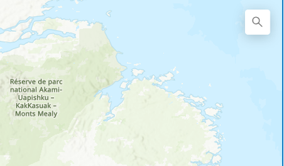

^ In this screenshot, only "Search" was toggled on in the settings and one can see the search icon is not housed in the "More tools" dropdown menu.
