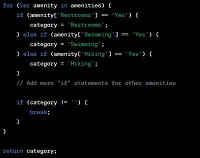

CGooch
I've also tried to use If statements like in the attachment that would reference each individual amenity field rather than the concatenated "Amenities" field, but it only returns one amenity.
