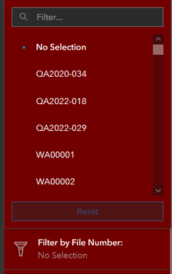

Once a Watershed is selected, my File Number list renders. This has helped to keep the Dashboard responsive. I've configured my "Filter by File Number" selector so that the categories are derived from Features. I have also enabled the "show filter" option which allows end users to search for a specific value. See below:
I think if you configure your selector to have Maximum Categories of 15,000 and then enable the search option your Dashboard will bog down. Chaining selectors together might be a good option to consider.
