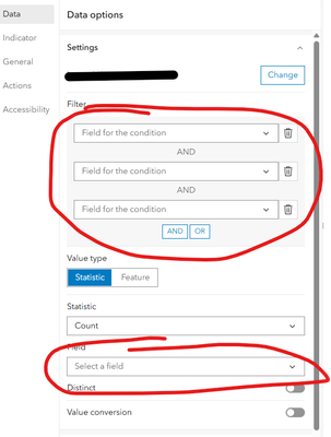

I support a rollback. Loading seems slower but once loaded it seems some improvement on filtering/calculation changes. However that is small in comparison to the broken, inconsistent map filtering I am experiencing.   Indicators work on some selections and not on others, And configured filters apparently still exist but are blank.

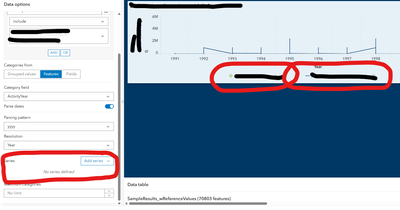

To add, series all apparently still exist somewhere but are missing from the configuration options, resulting in a broken, incomplete chart.  Unacceptable to release an update with these issues, I shouldn't have to rebuild from the ground up!
Edit: Going from what @NicolásPignataro said, I just checked out the JSON for these two dashboards. and the series and filters etc. still exist in JSON but are not displaying correctly in the app.

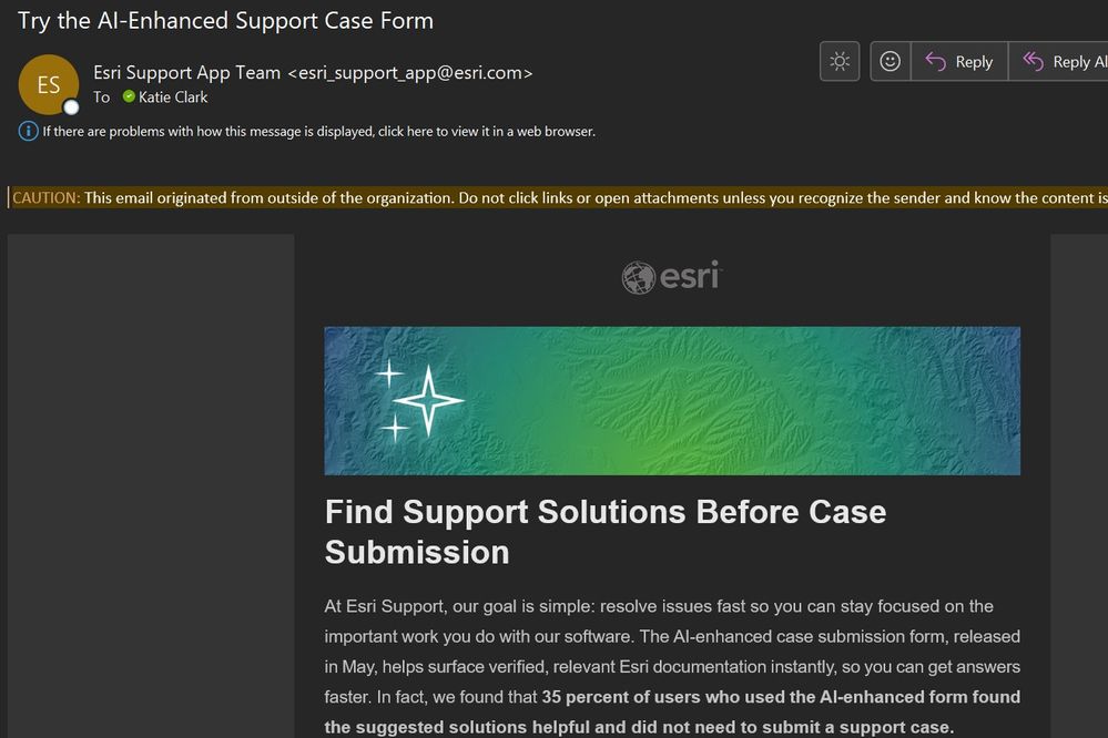

Update: I made my own post here
Side note, I did find it humorous that I received this automated email today, it could just be a coincidence since these type of marketing emails come out all the time, but I suspect they are getting flooded with support cases and really working overtime to correct their mess (as they should...)
