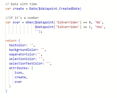

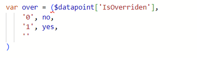

How would I convert values (0,1) with yes/no in a list?
This is what I tried but not right
Data Table:
KenBuja
MVP Esteemed Contributor
You should use the When function. Is the field numeric or a string?
//if it's a number
var over = When($datapoint['IsOverriden'] == 0, 'No',
                $datapoint['IsOverriden'] == 1, 'Yes',
//if it's a string
var over = When($datapoint['IsOverriden'] == '0', 'No',
                $datapoint['IsOverriden'] == '1', 'Yes',

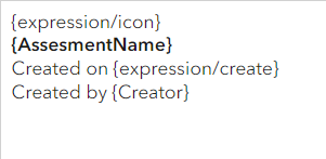

How are you constructing the text block?
dwold
@KenBuja I removed the == 0, 'No', line thinking the list would remove/hide the 0 values, but it still read Score override:  (because that is part of the text block)
(didn't think it would be that easy but gave it a shot)
Doing this:
and then:
{expression/icon}
{AssesmentName}
Created on {expression/create}
Created by {Creator}
Score override: {expression/over}

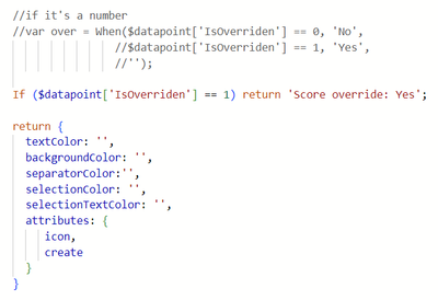

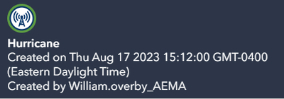

@KenBuja I'm new to arcade so I don't think I am doing something right. When I remove the text block that line is deleted (even values with 1/yes). Does the return call look in the right spot? See anything that I am doing wrong?
KenBuja
I'm sorry, I was incorrect. That should be
If ($datapoint['IsOverriden'] == 1) var over = 'Score override: Yes';
Keep 'over' in the attributes and {expression/over} in the template
