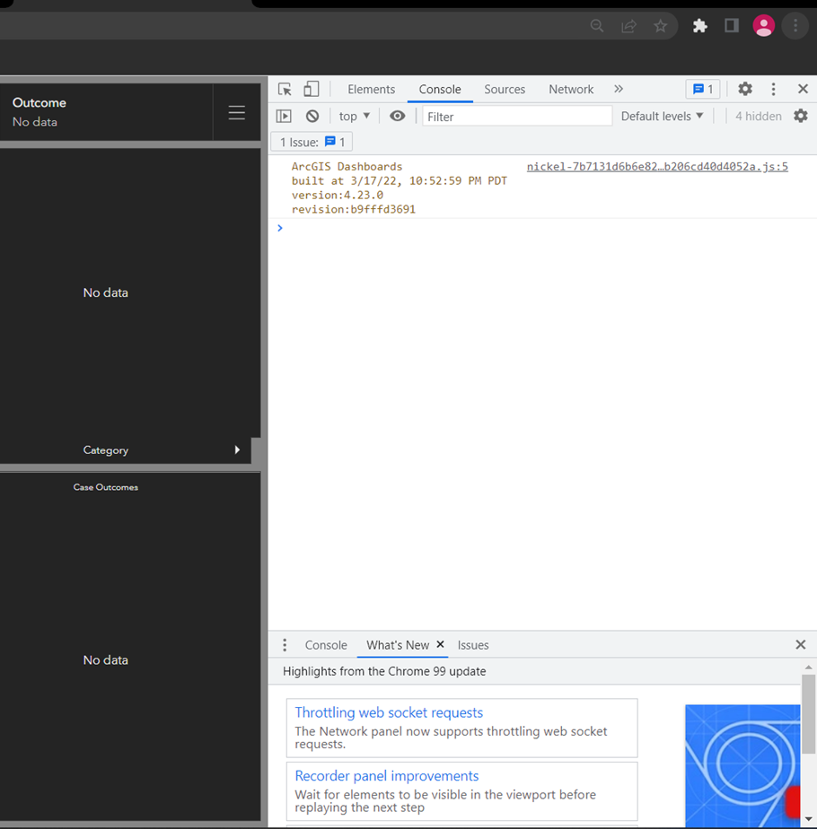

I have an issue relating to my dashboards not showing any data anymore. The map in the dashboard is also not showing any features. However, when I re-add the same map again, the data does shows no problem.
The error only started after the recent updates on 17 March.
I am getting the following issue/error in the console when the dashboard loads.
The feature layer that is not loading is a hosted feature layer view.

It seems the preset filters were the issue.
A number of filters were pre-set to open when the dashboard opened, the order of these pre-set filters had swapped around. I have no idea if this was something that anyone else has experienced. But it seemed to have taken place on all of the dashboards I had running.

Just to understand this, you can re-add the layer and it shows, but the existing layer won't? That seems very odd indeed.
Any chance the dashboard is public? If not, I'd suggest watching the Network tab of your browser's developer tools, to see what the dashboard is trying to do, and what response it is (or isn't) getting.

Is the original dashboard, without the re-added map, still showing the same issues today? Also wondering if there is a sample dashboard or if perhaps the original dashboard had a map extent filter to the elements that were showing 'no data'.
MichaelMole
