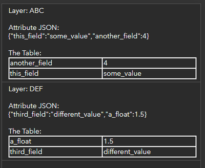

Just to demonstrate the concept, here's a sample FeatureSet:
var fs = FeatureSet(Text(
        fields: [
            {name: 'the_layer', type: 'esriFieldTypeString'},
            {name: 'the_attributes', type: 'esriFieldTypeString'}
        geometryType: '',
        features: [
                attributes: {
                    the_layer: 'ABC',
                    the_attributes: `{"this_field":"some_value", "another_field":4}`
                attributes: {
                    the_layer: 'DEF',
                    the_attributes: `{"third_field":"different_value", "a_float":1.5}`
Note that my two "layer" features have completely different fields and values in their the_attributes string. I'm using backtick strings, because in a real application of this, the values would be populated by something like ${feature.attribute}.
Bringing this into a list, we can then use this expression in our Advanced Formatting:
var dict = Dictionary($datapoint["the_attributes"])
var tbl_rows = []
for (var key in dict){
    Push(
        tbl_rows,
        `<tr><td style="width:50%; border:2px solid white">${key}</td><td style="border:2px solid white;">${dict[key]}</td></tr>`
var tbl_html = `<table style="width:100%; border-collapse:collapse;">${Concatenate(tbl_rows, '')}</table>`
return {
   attributes: {
    attr_dict: Text(dict),
    table: tbl_html
Which gives you this (I have the layer ID and the raw JSON shown, too):
With just a bit of tweaking to the CSS styling, there's no reason you couldn't get a tabular display of varying input schemas into a single widget.
