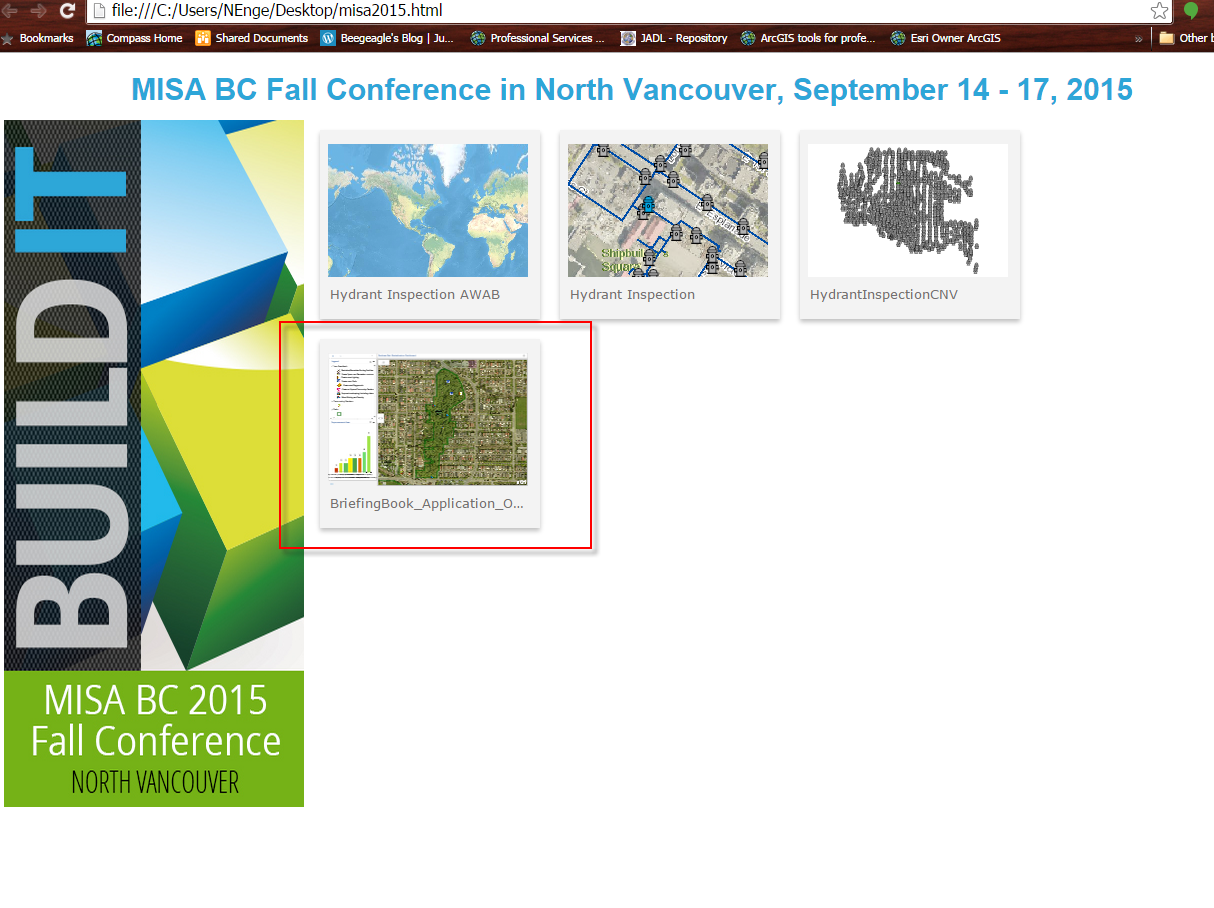

Hi, is there a way to force Operations Dashboard to Open in browser when shared to a group, and that group is shared and embedded in iframe to another website?
I have a group gallery application embedded within a website. And inside is an operations dashboard.

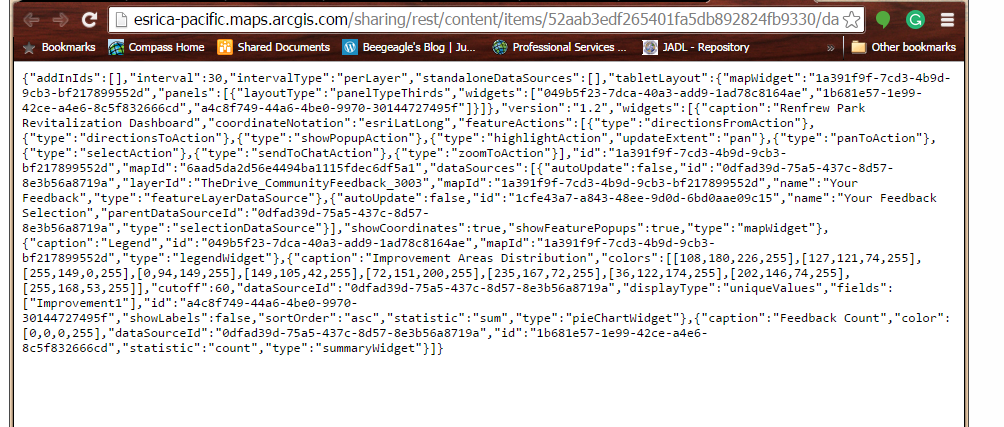

But when I click it, I get this

BUG-000090485: An Operations Dashboard Operation View shared with a public ArcGIS Online group will not be accessible when accessed through that group's gallery; instead of the Operation View, the JSON is returned.
