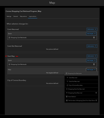

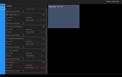

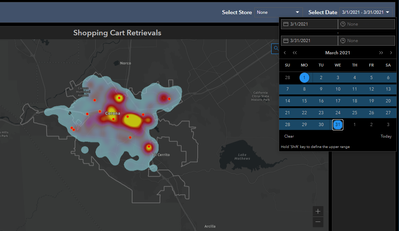

Hello, I created a dashboard that includes a date selector. It has several actions that filter the map layers, charts and indicators when a date is selected. I noticed that one of the layers (heat map layer) does not filter when a date is selected. The heat map layer is listed in the Date Selector “Actions” list. I noticed this happened after there was an update to the date selector.

Hello Mayra,
Do you try including your Date Selector in the filter actions of your Heat Map ?

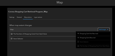

Thank you for your response.
There is no option for a Date Selector in the Heat Map actions filter.
