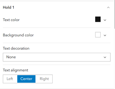

For instance, I want "Hold 1" to be two decimal places.  When I'm in the Table settings in the Dashboard editor, and I go to "Values", the only formatting choices I see are these:
Am I not in the right spot?  I've looked through all of the left-side tabs in the Table settings window and can't find it.  The data for the table is coming from a hosted feature layer directly.

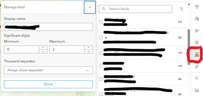

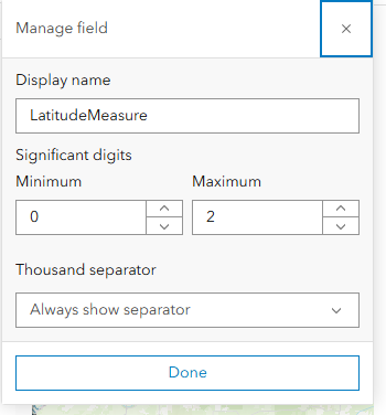

@RobbieKieffer In AGOL open the feature layer in a map. -> on the properties of the feature layer. In the properties menu there should be a item called fields:
Then click on the field you want to change.  If it is a decimal field you should get a popup like this where you can adjust the number of sig digits etc.:

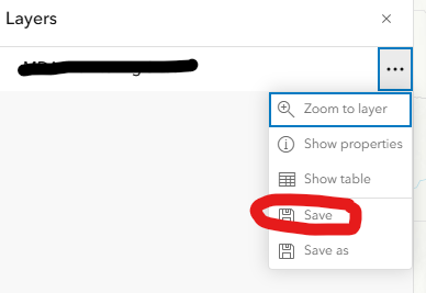

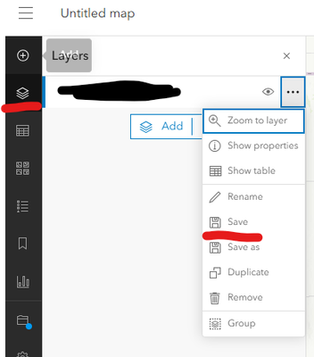

Once you are done, go to the that layer, click the three dot menu and save.
It should follow through to your dashboard.

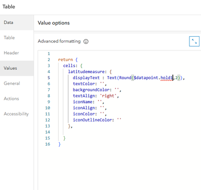

You can also use the advance formatting option in dashboards to achieve this.  In the values tab select advanced formatting and use the Round() function to only return 2 decimal places:
edit: add link
https://developers.arcgis.com/documentation/app-builders/no-code/arcgis-dashboards/calculate-and-for....
