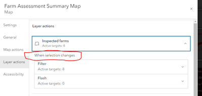

I have a category selector that filters a river catchment map layer. This catchment map layer simultaneously filters an "Inspected Farms (point)" map layer. Is it then possible to filter my indicator, sourced from a data expression, with common fields with the inspected farm layer ??
Can't seem to get this working and is likely operator error!

For clarity I don't have a direct common field linkage between the catchment layer I use as a category selector and the Data Expression feeding my Indicator. It is a "chain or nested" linkage - so the catchment selector filters the "inspected farms" map layer and this layer has a common field linkage to the data expression in the indicator. I was hoping to be able to trigger filtering on the indicator data expression from the changes in inspected farms layer but from what I read it seem only possible to get this realised via a screen selection after the Catchment category has filtered the inspected farms.
I hoped to do this via the "Layer actions" tab in the map settings but this seems to be sticking point below. I have to use Lasso tool to make manual screen selection to get the indicator to filter further down rather it being a 1 step process. Maybe it's not possible this way.
Thanks for any pointers.

Can anyone shed light on this at all?
Catchment selector - filters Inspected farms on shared ID. Can my Inspected farms layer (based on shared farmcode ID) filter the indicator (FeatureSet with FarmCode ID) without having to make a selection beforehand?
