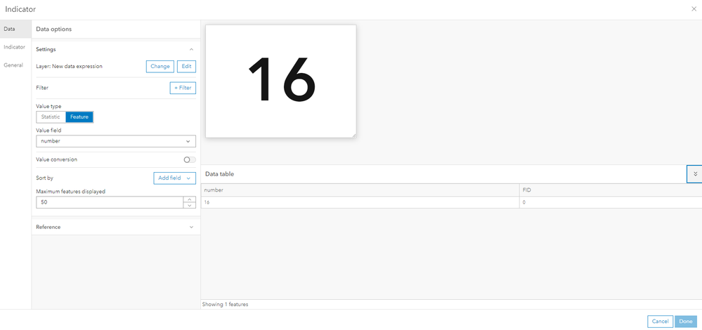

Indicator shows "No data" as soon as Map Actions is enabled.
1622
08-10-2022 10:03 PM
EhsanKafai
I have used the data expression below for an Indicator in my dashboard to sum fields across layers. the Indicator works fine, but as soon as I enable Map Actions for that Indicator, the Indicator stops working.
Any ideas on how to resolve the issue?

EhsanKafai
It seems that a BUG has been identified for the issue.
BUG-000151997 Arcade functions are unable to sum and combine features while maintaining the geometry so that map actions can be applied in ArcGIS Dashboards. https://support.esri.com/en/bugs/nimbus/QlVHLTAwMDE1MTk5Nw==
