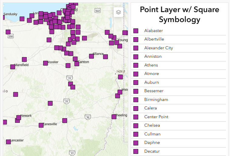

The built-in icon symbology is based on the layer source. If you are pulling the layer in from the map it will display the map symbology, if it is pulled in as a stand alone layer, it will display the default symbology of the layer.
Notice how both layers still use the polygon shape as the icon. Your image displays a square icon and you state your are using the default icon setting. To me, that indicates that your list data layer is a point layer that uses square symbology. I would check that you are using the correct layer in your list.

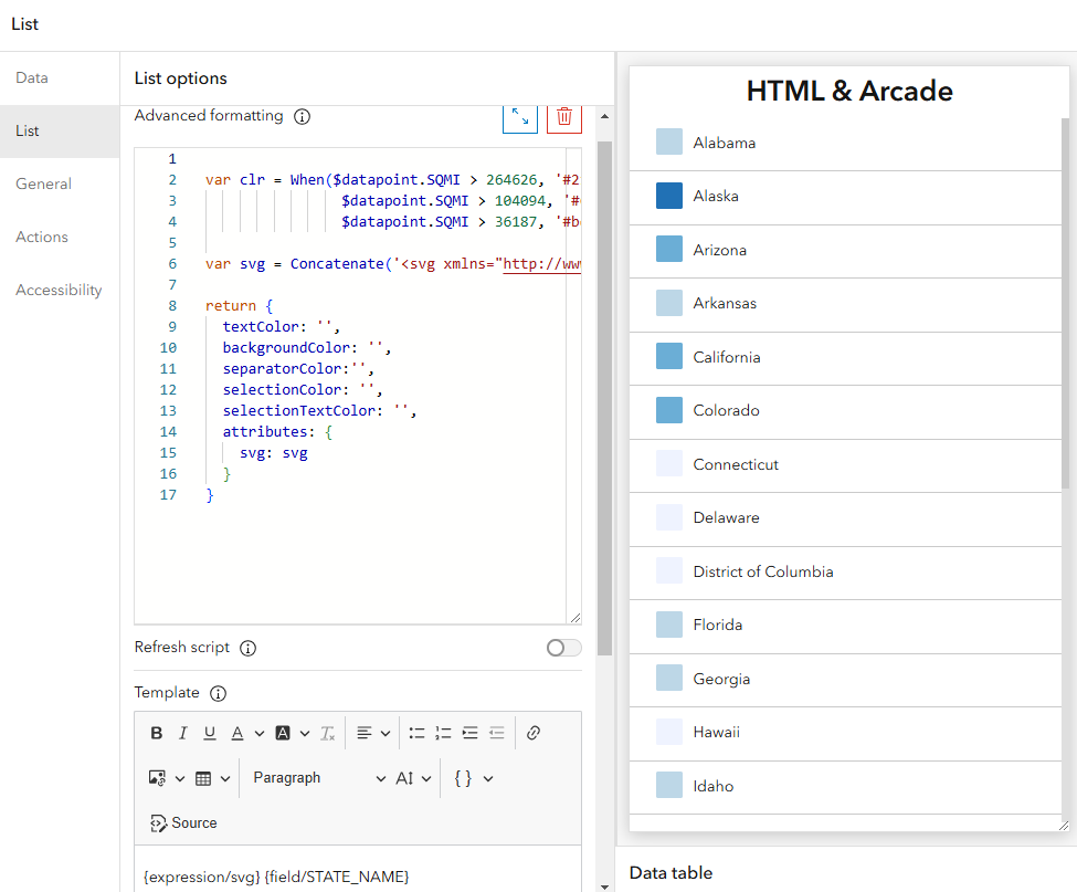

If you are not using the default icon setting, and are using HTML to display a custom icon, then you need to use Arcade to explicitly set the values. You cannot pull from your map symbology.
// Dynamic Icon
var clr = When($datapoint.SQMI > 264626, '#2171b5',
                $datapoint.SQMI > 104094, '#6baed6',
                $datapoint.SQMI > 36187, '#bdd7e7', '#eff3ff')
var svg = Concatenate('<svg xmlns="http://www.w3.org/2000/svg" width="32" height="32" fill="' + clr + '" viewBox="0 0 256 256"><path d="M224,48V208a16,16,0,0,1-16,16H48a16,16,0,0,1-16-16V48A16,16,0,0,1,48,32H208A16,16,0,0,1,224,48Z"></path></svg>')
return {
  textColor: '',
  backgroundColor: '',
  separatorColor:'',
  selectionColor: '',
  selectionTextColor: '',
  attributes: {
    svg: svg
- Jen
