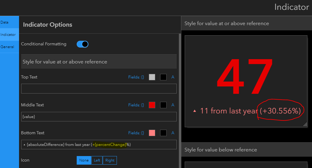

Hello,
I am using the {percentChange} arcade syntax to show the percentage increase or decrease in a YTD indicator in dashboard. It works great, but as shown in the screenshot provided, the resultant value is not rounded.
Does anyone know how to make sure the value gets rounded?

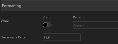

Scroll down on that screen to Formatting. Change the Percentage Pattern to "##.#", see if that works.
SteveOwens
MichaelBouvet
This worked! Thank you so much!
