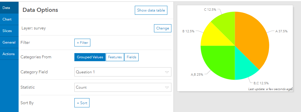

I generated an example using a multiple choice question in Survey123.  What result do you get when selecting a pie chart and assigning the following parameters?  Picture for reference.
-Categories From = Grouped Values
-Category Field = ethnicity question
-Statistic = Count
Jake

Jake,
Thanks for your response. I've given this more thought. I think that I need the option of showing percentages for each individual ethnicity. I expect thousands of responses. Given that there are 7 possible answers, there could be 25, 50, or 100 different combinations. This would make it challenging or impossible to add the correct labels as well. I think that my only option is to add 7 calculated fields to my survey (hidden from the user) to keep totals for each individual response. Then, in my dashboard show those 7 fields in a serial or pie chart. I may need to break it down by gender as well. Do you think that will work?
Thanks,
Chuck
